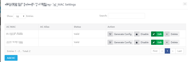

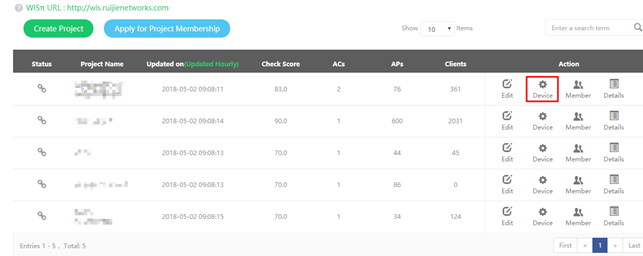

Step 3: check the WIS project info on WIS site:
We need to make sure the AC's MAC address is correctly added on WIS. Note: If VAC is performed, all MAC addresses of VAC members should be added to WIS.
