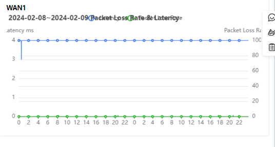

I already I identified that 1 of my ISP is loosing packets during 8-10pm everyday, thanks to ruijiee diagnostics>Link Connectivity Connection. it has history of ping and packet loss.
after Identifying that one of my uplink is bad, I put it to secondary and just use the good ones.

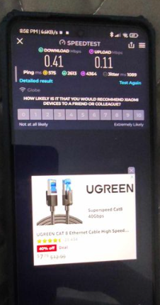

but still I get a report from my customer that shes getting very slow internet this is 1 customer out of 100.( cant tell if others are expriencing the same thing some people will just not report).
Its also important to note that I dont have this problem during daytime.
Ichecked ruijiee during the time it was reported its about 9PM.
WAN PING:  4ms
Packet loss: 0%
So im sure my WAN is Good.

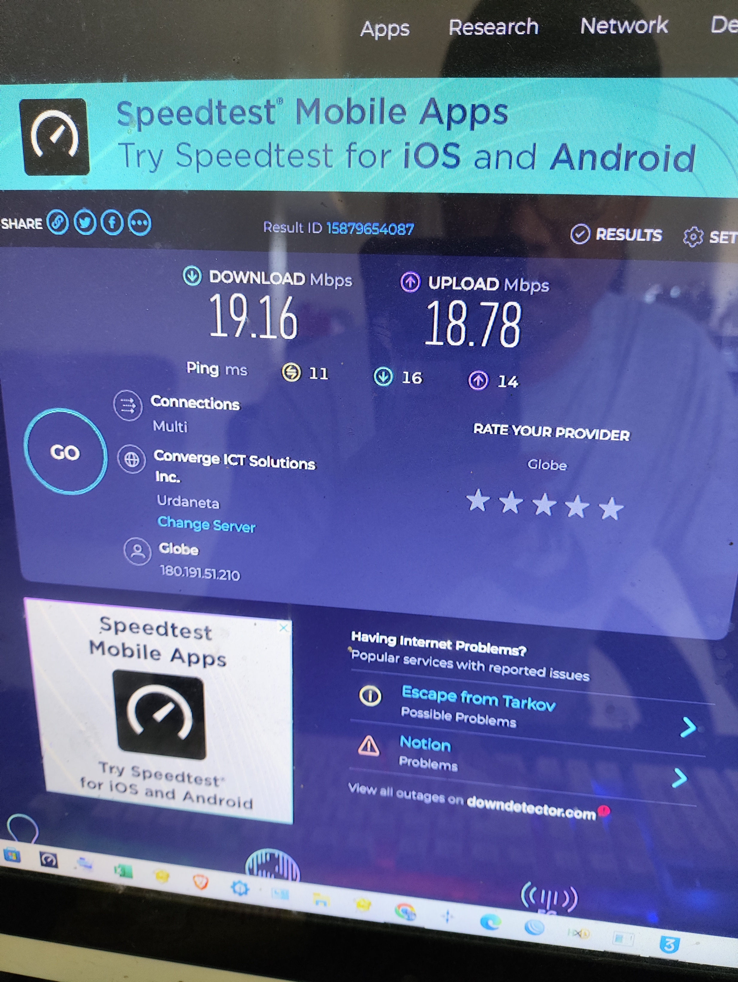

Checked my WAN1 Speed during the time customer is getting slow speed.
its just around 300mbps my wan1 link is 500mbps

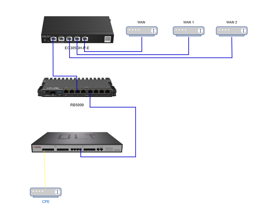

aside from that I dont know where to look, atm rb5009 is still working as my pppoe authenticator.

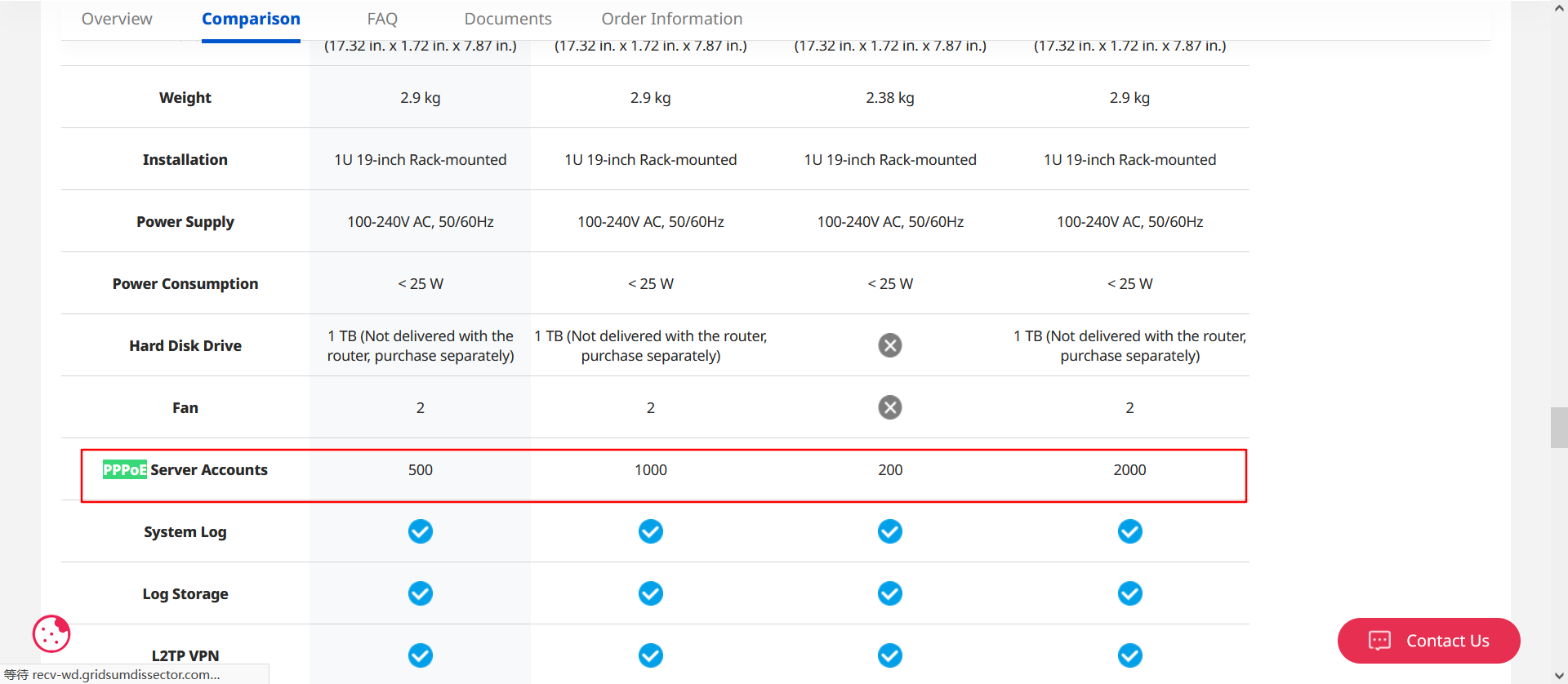

Im planning to move all my pppoe accounts to Ruijiee, but ruijiee can only do 128 active pppoe clients.
do they have a bigger gateway that can handle morethan 128 active ppoe clients?
if Ill keep my topology using rb5009 as my pppoe authnticator any suggestion where to look when my customers are getting slow speed at night?

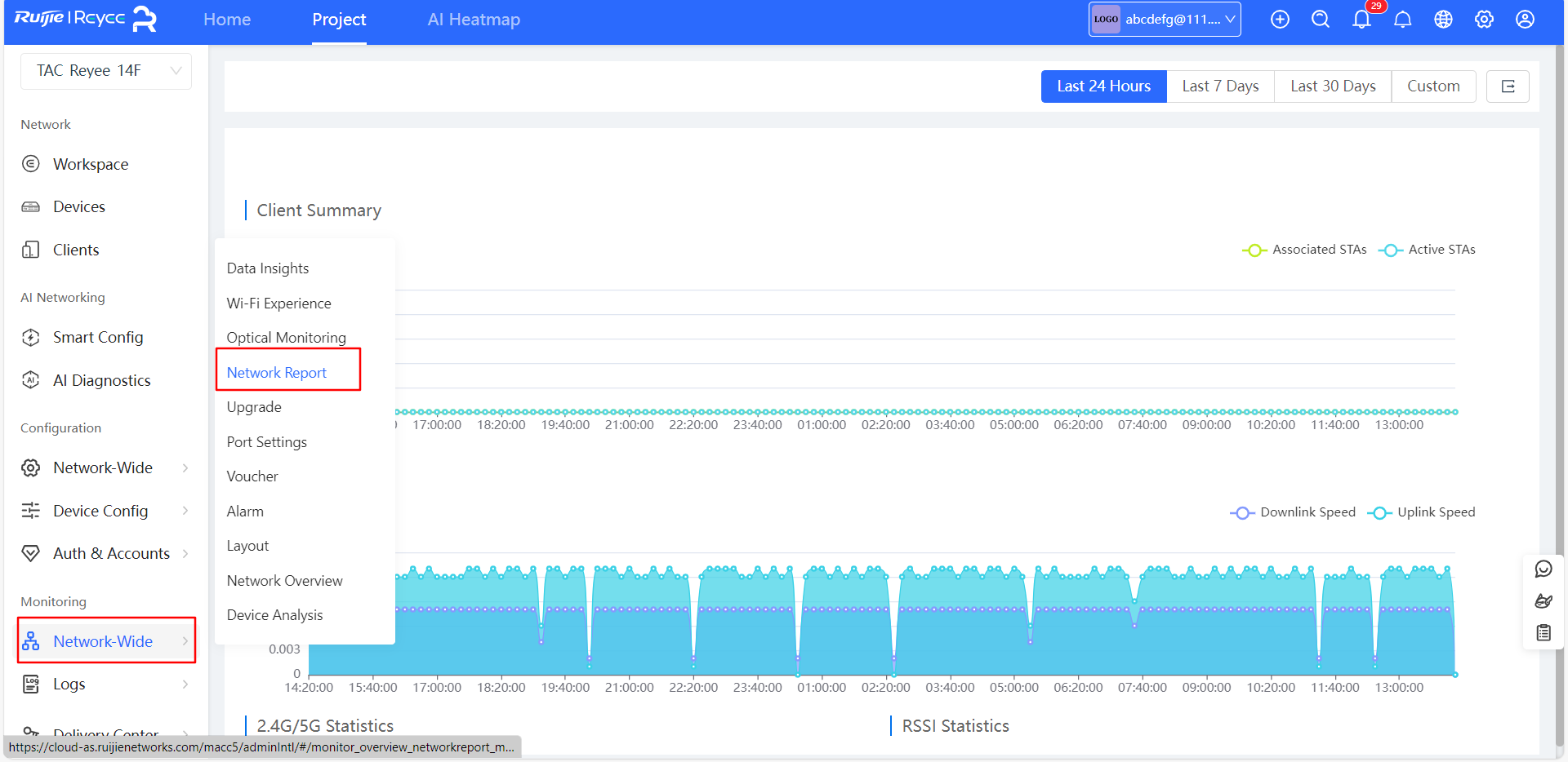

If you have added the device to cloud, you can check the client network report on this page:

0 2024-2-10 14:13:47 View all replies

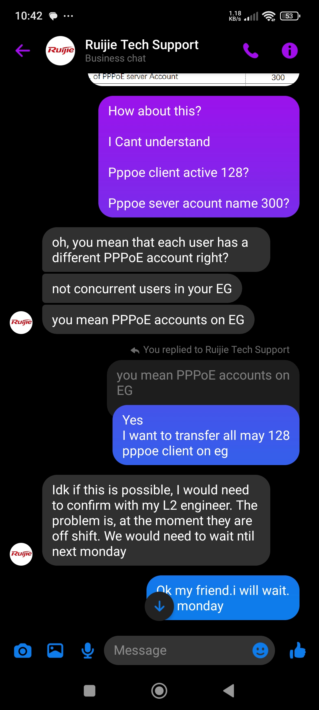

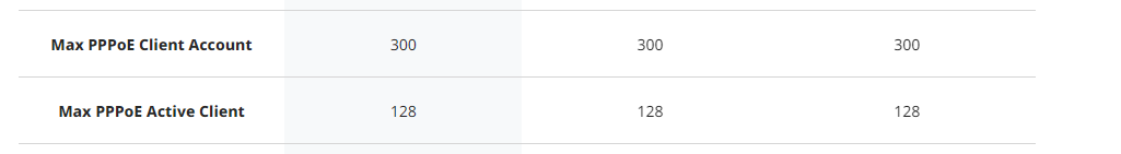

can you confirm if those numbers are the number of accounts or number of ACTIVE PPOE CLIENT ACCOUNTS?
like on this page it is specified , the max number of ppoe account and the number of active pppoe account.
https://www.ruijienetworks.com/products/reyee-router/Cloud-Managed-Router/RG-EG305GH-P-E/
on your link, it says SERVER account, but how many ACTIVE PPoE client it can handle?

I tested it its really way way off.
25 mbps can go to 75mbps
2 mbps can go to 4 mbps.
OMG
0 2024-2-12 21:28:32 View all replies
icantsleep replied at 2024-2-12 06:08
How inaccurate? I have not tried mine. sample you put 25mbps how much customer is getting?
25mbps on client
Speedtest up to 50mbps

If you have the budget to go for the bigboys of ruijie just look at my diagram and remove mikrotik all the way.
