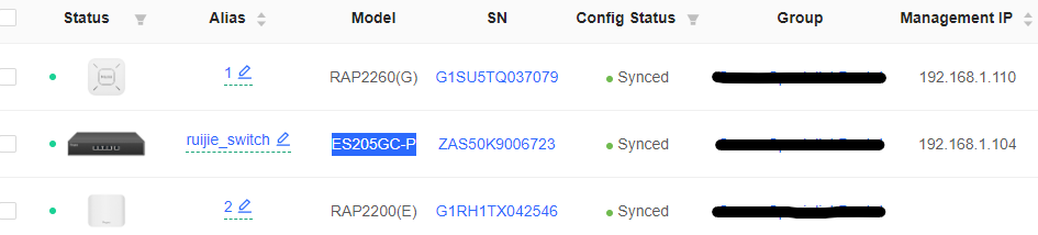

Hi

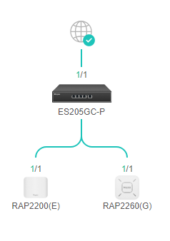

I have two AP (RAP2260 G) and (RAP2200 E) connected to the Switch ES205GC-P.
The switch is connected to another ISP Provided router and is this ISP router is a DHCP server.(192.168.1.1 - 192.168.1.254)
When I get connected to RAP2260G I get the IP address series same as the ISP router (192.168.1.x) but when i get connected to AP RAP2200E, the IP address I get is different 192.168.120.x.
I would like both the APs to serve from the DHCP server. Kindly need guidance. This is a default configuration and no changes made.
Thanks in Advance
Vicky

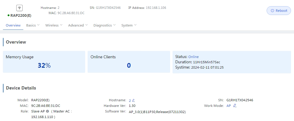

Dear Vicky Boy,
Could you please log in the eWeb of RAP2200E and check what is its management IP address? Please also check if its current work mode is AP mode, if not, please change it to AP mode.
Jayden
0 2024-2-11 12:02:26 View all replies
GTAC-Jayden replied at 2024-2-11 11:55
Dear Vicky Boy,
Could you please log in the eWeb of RAP2200E and check what is its management IP ad ...
Thanks for your reply Jayden,
Yes its already showing as AP.
This is also showing as slave
0 2024-2-11 12:09:43 View all replies
Vicky Boy replied at 2024-2-11 12:02
