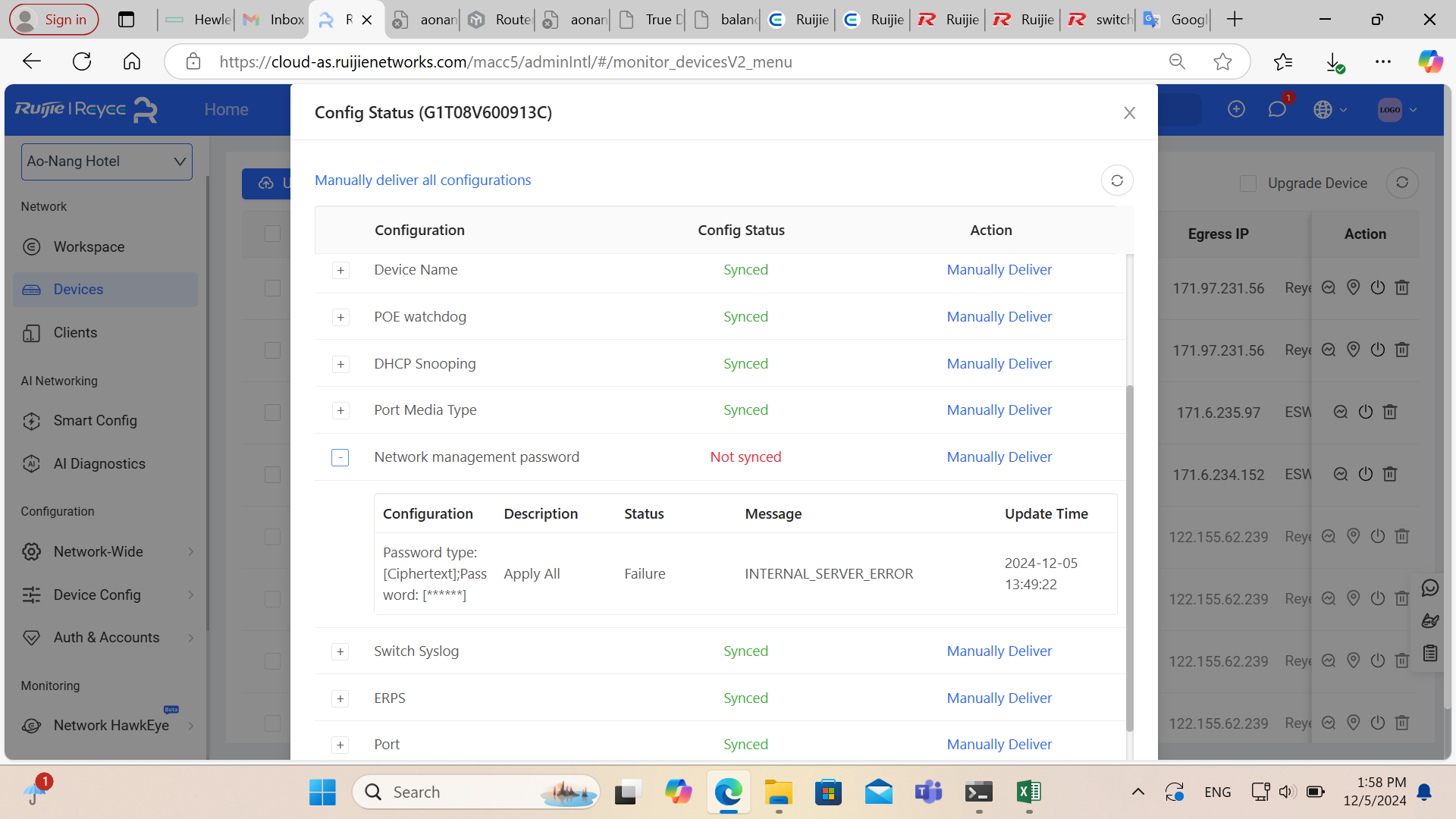

Dear Tom,
Thank you very much for your help.
I have reset the switch and the result is the same as the picture attached below.
Please give me some advice.
Best Regards,
Nantachai
