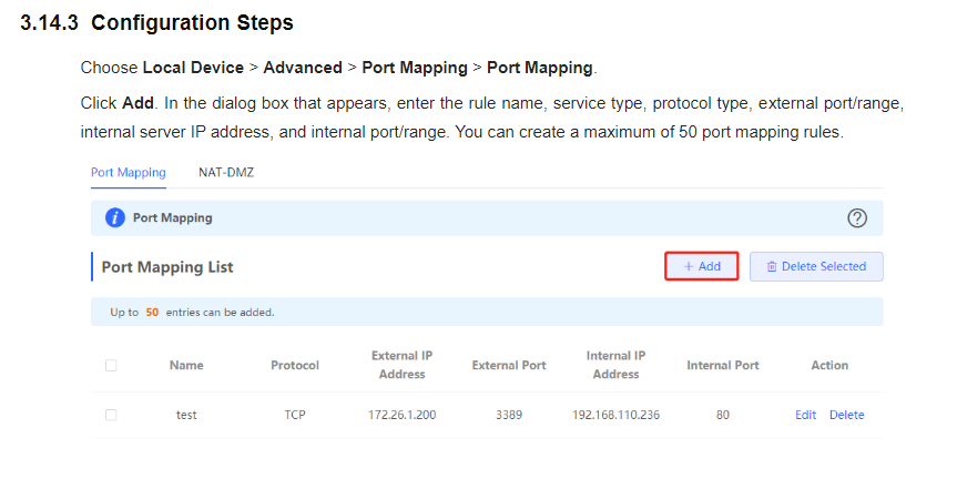

Is it possible to connect to the device remotely via IP? Is it possible to do this only through the cloud? If possible, please give a hint as to how this can be done, thank you!

Dear Микола Марченко,
If you want to configure port mapping on EG105G V2, please refer to page 126 of the configuration guide in the link below:
https://www.ruijienetworks.com/resources/preview/ruijie-reyee-rg-eg-series-routers-web-based-configuration-guide-release-reyeeos-2-248-en
If you want to access the eWeb of the EG105G V2 via its WAN IP address, please kindly note Reyee EG does not support accessing eWeb using the WAN IP address.
