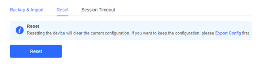

Q8: If a bridge group is created for two devices by mistake, how do I delete them from the current bridge group?
You can reset both devices to factory settings by following stage
Choose System> Management> Reset Click Reset to restore factory settings
Caution:This operation will clear existing settings and restart the device. Therefore, exercise caution when performing this operation. If there is any configuration in the current system, please export the configuration before resetting the device.

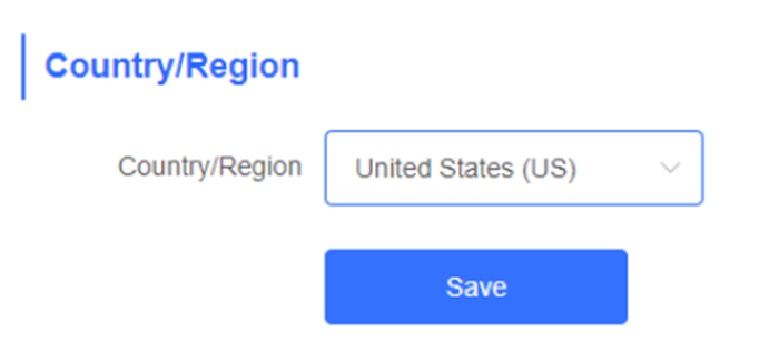

Q33: Can batch edit the country code of device?
Yes, you can do it by following steps:
Choose Wireless Country/Region
Choose the target country/region from the drop-down list, and click Save
Note:
Country/region code change takes effect on all devices in the entire network, that is, all bridges on the Overview page. Therefore, before changing the country/region code, confirm that the target device is on the live network and the WDS link works well.
After the country/region code is changed, the Wi-Fi network will restart, and the AP and the CPE will be connected after the Wi-Fi network is restarted.
