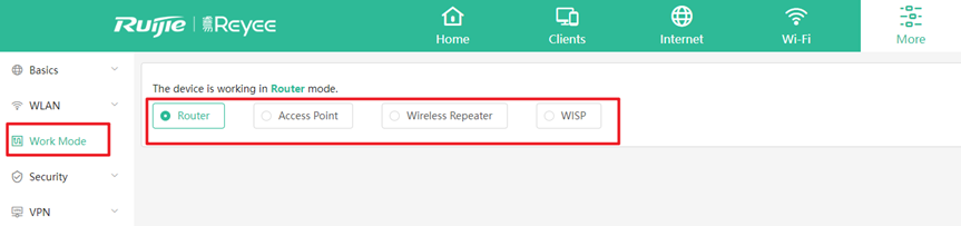

Overview
Reyee EW Router has four modes to choose from atthe beginning (router mode, relay mode, Mesh wifi, WISP), and two modes(EWEB/APP).

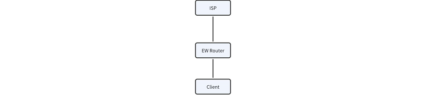

2.2 Issue Analysis
①Confirm whether the selected internet accessmethod is correct (PPPoE or DHCP).
②Check if the ports connected to the router andoptical modem are correct
③Confirm that the wifi password is enteredcorrectly.
2.3 Solution
① If directly connected to ISP , you need to confirmwhether the PPPoE account password is correct
② If it is connected to the modem provided by theISP , confirm the LAN port connected to the optical modem side and the WAN portconnected to the router side
