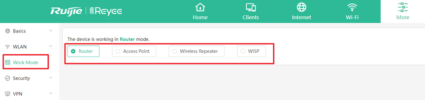

Is the mode of the relay router correct?

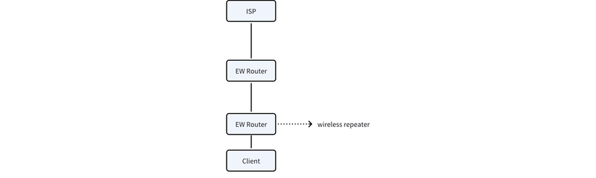

Check the distance between the two routers if theyare connected wirelessly in relay mode
In wired scenarios , whether the two ports areconnected correctly

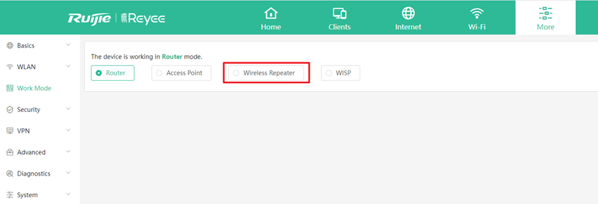

Confirm that the relay router is in relay mode

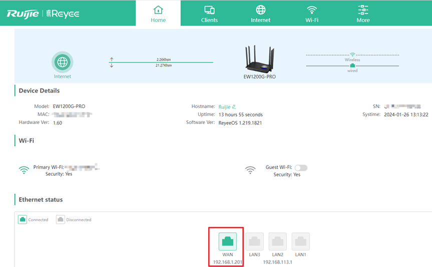

④ In wired scenarios , the main router is connectedto the LAN port, and the relay router is connected to the WAN port
