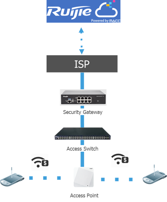

2. Network topology

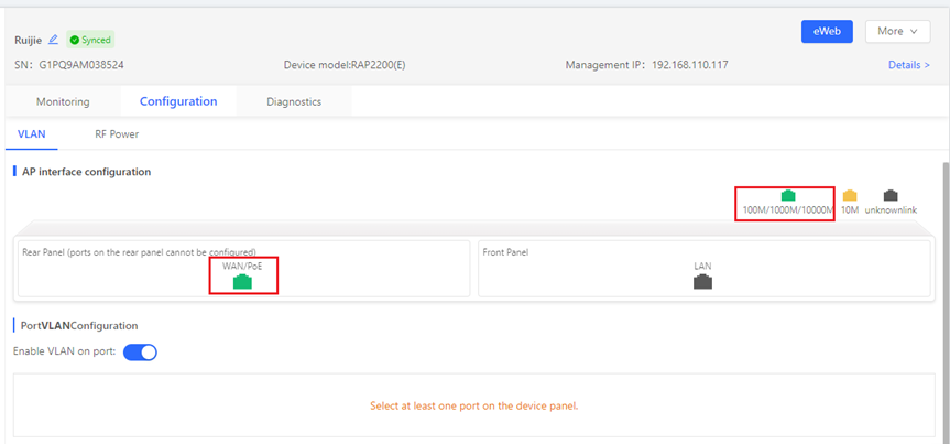

(3) AP 's uplink wired port bandwidth is insufficient
Because all wireless clients'Internet traffic must pass through the AP 's uplink wired link, it is necessary to ensure that the AP's uplink wired bandwidth is sufficient. You can view the AP's uplink bandwidth in the device's CLI by commanding "show interfaces status".
Note : If the port support negotiation of AP is 1000M, but the current Speed is not 1000M, then:
1. Check if the network cable supports 1000M.
2. Check whether the port connected to the uplink device and the APsupports 1000M;
3. Replace the network cable for testing.

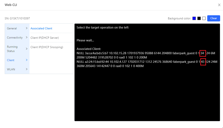

View the RSSI value of the wirelessuser on the AP:
You can view the user 's current signal strength inthe device's CLI with the command "show dot11 associationsall-client".
Note 1: The displayed RSSI refers to the test device received signal strength, ranging from 0 to 100 (the corresponding wireless user signal strength is -95 on this basis, for example, RSSI 40 in the figure above, the corresponding wireless user signal strength is 40-95 = -55dBm)
Note 2: If the RSSI value is low(below -60dBm), it is recommended to move the test device to a position closer to the AP or increase the power of the AP appropriately, so that the testdevice user can obtain a higher RSSI value.

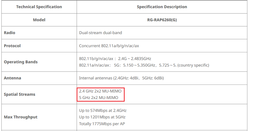

The factors affecting the maximum negotiation rate are:
1. The wifi protocol (wifi6 or wifi 5) supported bythe AP and the test device;
2. The number of spatial streams supported by theAP and the test device;
3. The bandwidth configured by the AP. The more spatialstreams and the larger the bandwidth value, the higher the negotiation rate.You can check the product specification to confirm the number of spatialstreams and bandwidth supported by the product.
(As far as mobile phones are concerned, supporting Wi-Fi 5 means a single spatial stream, while supporting WiFi 6 means a dualspatial stream.)
1) 802.11acwireless negotiated rate set
(For example, when the wifi6 mobile phone is connected to the AP720-L (2 spatial streams, Wi-Fi5) speed test, when the AP configuration bandwidth is
80Mhz, the maximum negotiation rate can reach 866.6Mbps, the actual speed test result should be range from 400M - 500Mbps)

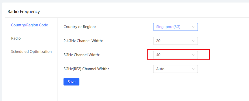

2. In addition, the negotiation rate is also related to the Channel Width. When configuring a higher Channel Width, the wireless test device and AP device will have a higher negotiation rate, but the higher the Channel Width, the greaterthe wireless interference. When the negotiation rate is low, you can change theChannel Width configuration or enable Wi-Fi 6 to improve the rate.

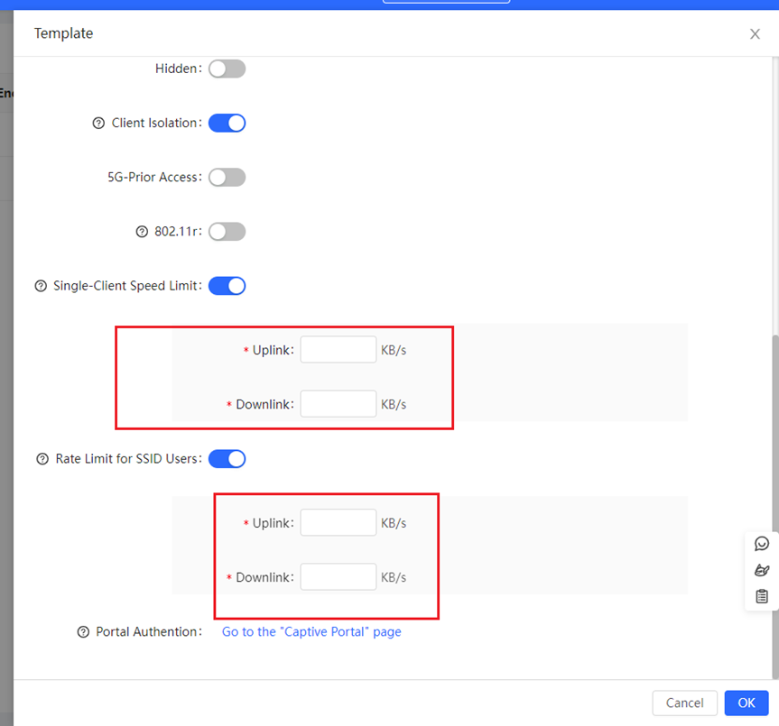

If there is speed limit configuration on the AP, the configuration needs to be deleted.
Note: If the Channel Width is lowerand the user can obtain sufficient negotiation rate, it is not recommended toincrease the Channel Width to avoid greater wireless interference.

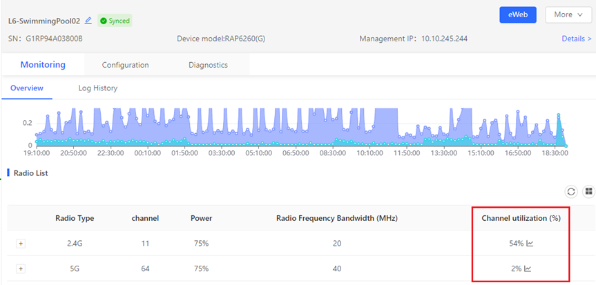

(6) High channel utilization
High channel utilization will affectwireless experience of clients.
You can view the current utilization of AP 's radioin Cloud
Idle: 0%-59%
Busy: 60%-79%
Overload: 80%-100%
If the device is launched in the cloud, you canview the channel utilization rate in the device list.

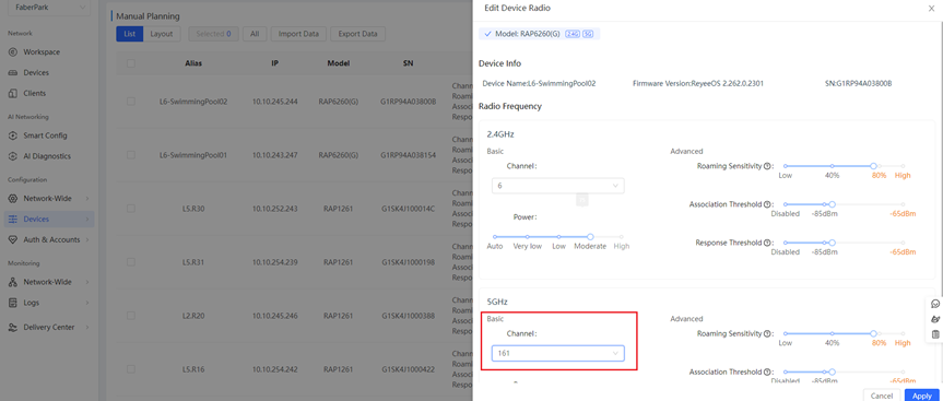

When the channel utilization state is Idle, it indicates that the channel currently used by the AP is relatively idle, and the wireless interference is small; when the channel utilization state is in the Busy or Overload state, it indicates that the channel currently used by the AP is relatively crowded, and the wireless interference is large. It is recommended to change the channel used by the AP and test again.
The working channel of the device can be changed with the following command:
