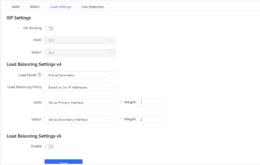

Hi Support
I have resolved the problem
SIP ALG must be on and this Load Settings
0 2024-3-6 22:05:41 View all replies
Jacques Rossouw replied at 2024-3-6 21:06
Hi Support

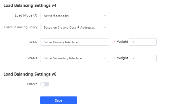

Hello Support
Nope still getting a problem with SIP Voice calls going out onto LTE. SIP ALG not working
I have changed setting to, will test and see if it works....
