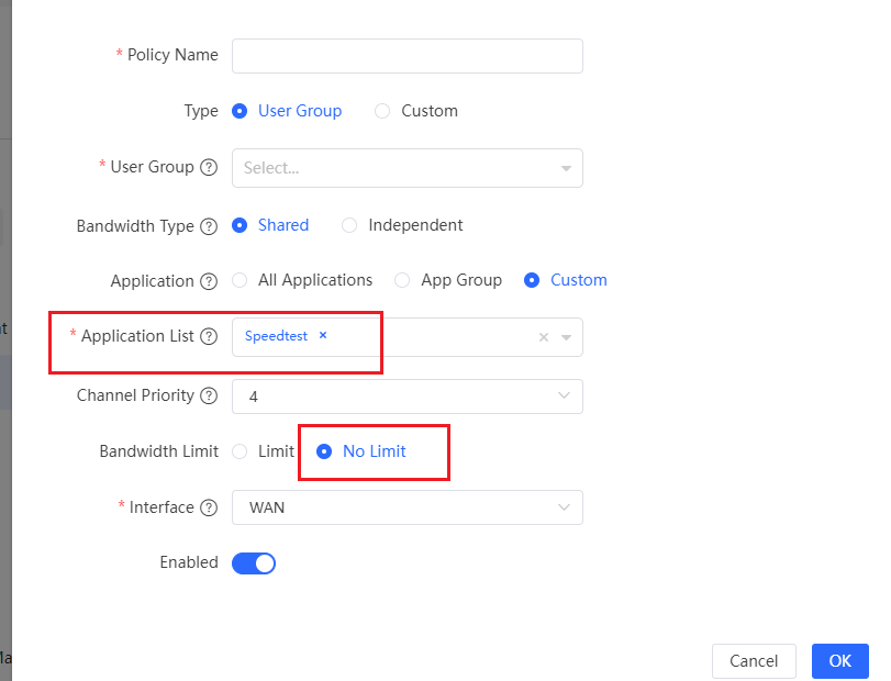

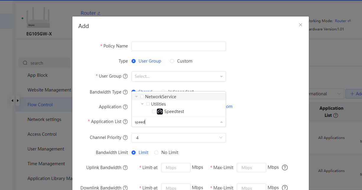

You want users to speed limit at 10Mbps, but when they use speedtest, they get a higher speed, not 10Mbps only, right?
If yes, you can configure like this:
1. set user speed limit policy with 10Mbps as normal configure from the guide.
2. set speedtest as "no limit"

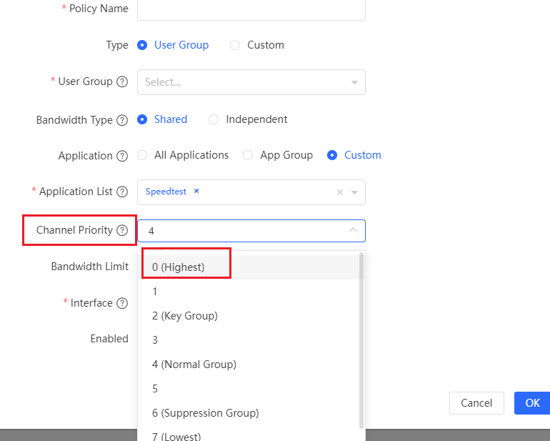

3. Channel Priority of speedtest rule to 0
