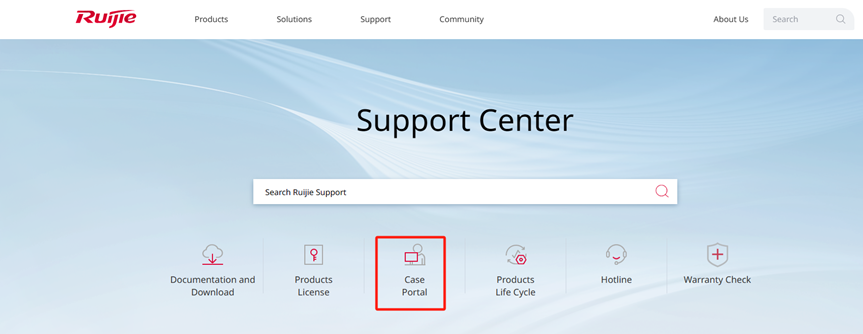

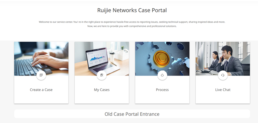

Log in to the official website and open case portal;Support | Ruijie (ruijienetworks.com)

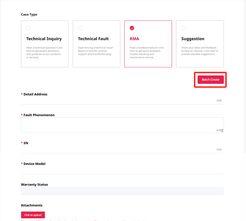

Create a single RMA case
1. After entering Create a Case, the customer needs to select the case type (RMA), fill in the case detailed address(used for receive spare part), fault phenomenon, SN,attachments, and then submit the case directly.

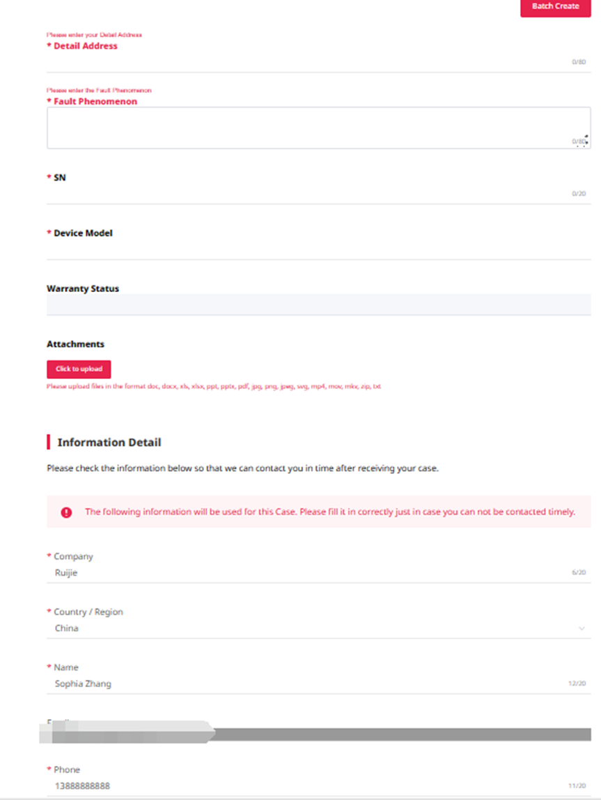

Batch create RMA case
1. After entering Create a Case, the customer needs to select the case type (RMA), andthen click Batch Create.\
2. Fill in the detailed address (used for receive spare part). You can click "+AddA Row" to add multiple devices, fill in the fault phenomenon, SNs,attachments, and then submit directly.
