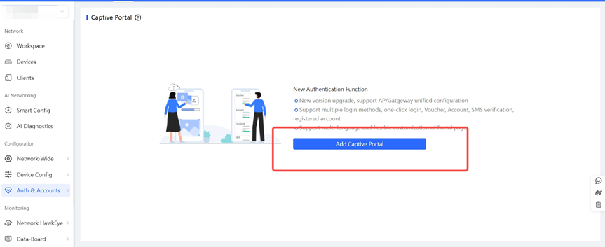

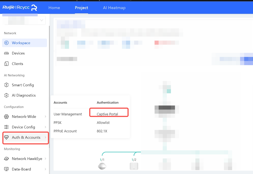

1. Select a project-->Auth & Accounts-->Captive Portal
2. Click Add Captive Portal

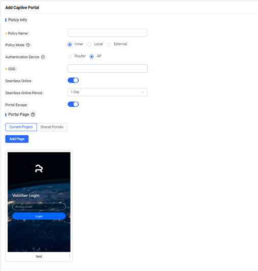

3. Fill in the basic setting of the Captive Portal.
Note:
Policy Mode: Select the mode as Inner
Authentication Device: Select the mode as AP
Seamless Online: If this function is enabled, acertain STA can enter portal within allowed time range without portal poppingout.
Portal Escape: If this function is enabled, STAwill be allowed to connect to SSID even its voucher or account verification is wrong.

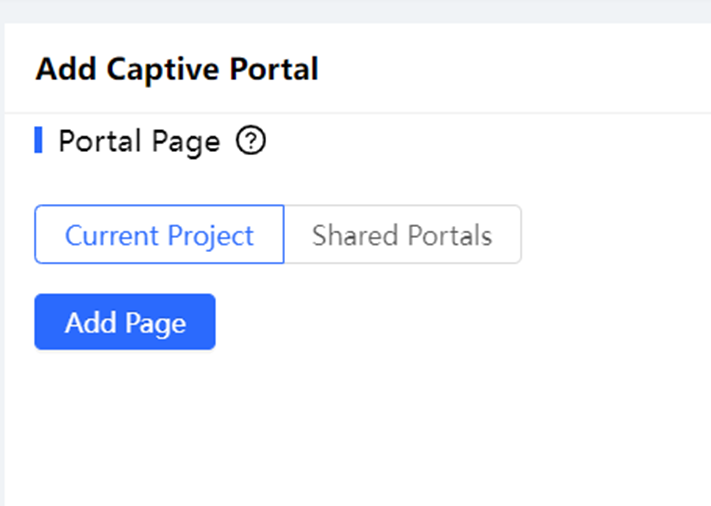

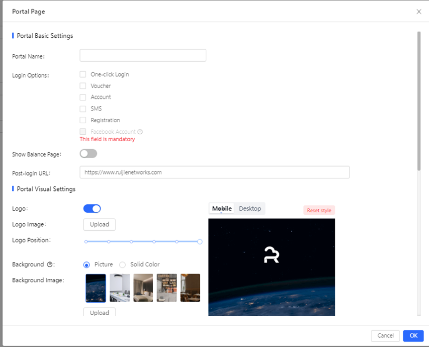

4. Set the portal page:
