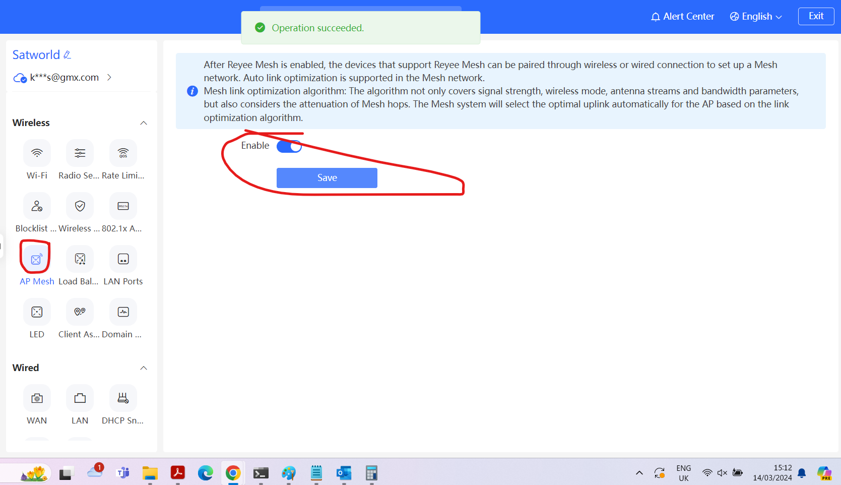

I have to APs connected into 2 switches in same network. Switches are in place A and B linked by cable.
2 APs connected into different switches but in same network. I would like to turn on option for automatic change from LAN to WLAN uplink when cable between switches will be broken or unplugged. So after unplug cables between switches, offline AP will connect up to other AP which is online and keep other part network up and running until service man come.

Lukasz Ptak replied at 2024-3-14 23:15
AP Mesh is Enable, where is Self-Healing Mesh function ?

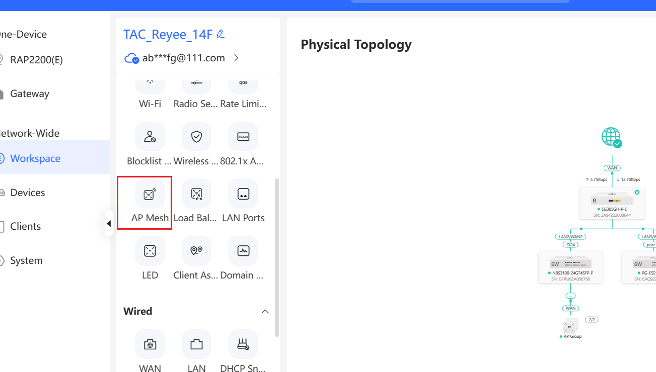

Hi:
You can find the Self-Healing Mesh function on the interface of the AP:
