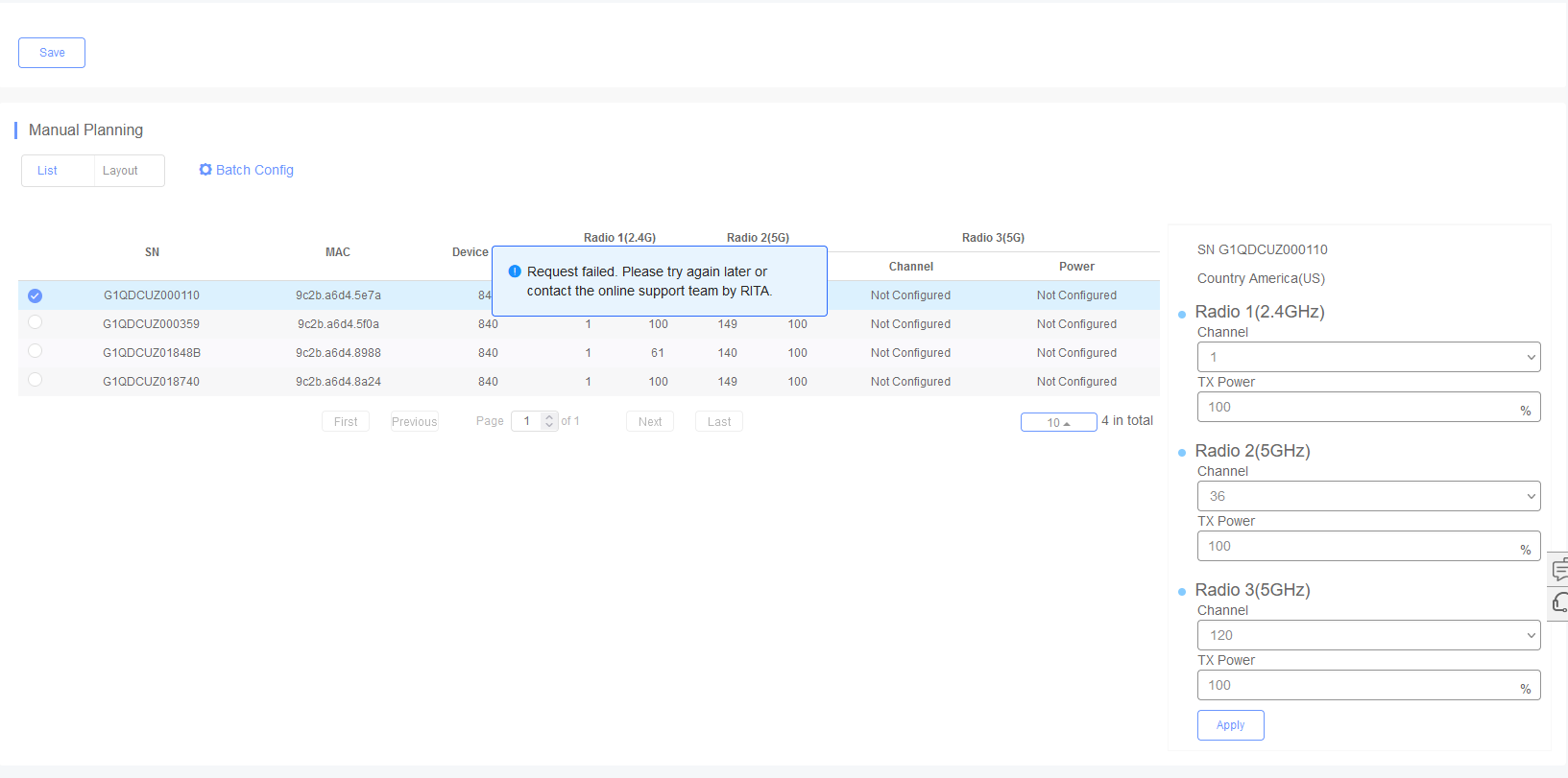

I can't not configure channel at Ruijie 840 Aps Reply
Wai Yan Moe
3867 1 2024-3-18 17:02:44
How can i fix that issue and i am facing that issue both Ruijie 840 and 730 model.
RG-AP840-I
0 2024-3-18 19:37:34 View all replies
May i know if you configure radio of APs on the sub-project
if so, this is existing issue with Cloud and R&D still working on it
but we can configure radio settings on the web interface of the AP
or configure radio setting via commands:
Ruijie#configure terminal
Ruijie(config)#interface dot11radio 1/0
  ---->2.4G
Ruijie(config-if-Dot11radio 1/0)#channel 6
Ruijie(config-if-Dot11radio 1/0)#exit
Ruijie(config)#interface dot11radio 2/0
  ---->5G
Ruijie(config-if-Dot11radio 2/0)#channel 153
Ruijie(config-if-Dot11radio 2/0)#end
Ruijie#write
Ruijie(config)#interface dot11radio 1/0 --->2.4G
Ruijie(config-if-Dot11radio 1/0)#power local 50 -----> Adjust the transmit power to 50%.
Ruijie(config-if-Dot11radio 1/0)#end
Ruijie#write
Ruijie(config)#interface dot11radio 2/0 --->5G
Ruijie#write
