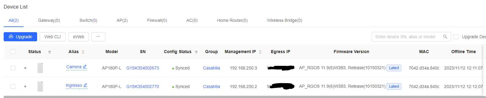

HI,
It has often happened to me that the devices registered on the cloud-eu.ruijienetworks platform are unreachable.
However if I try to contact them from the LAN they work perfectly.
Could you tell me where I'm wrong?
Thanks in advance.

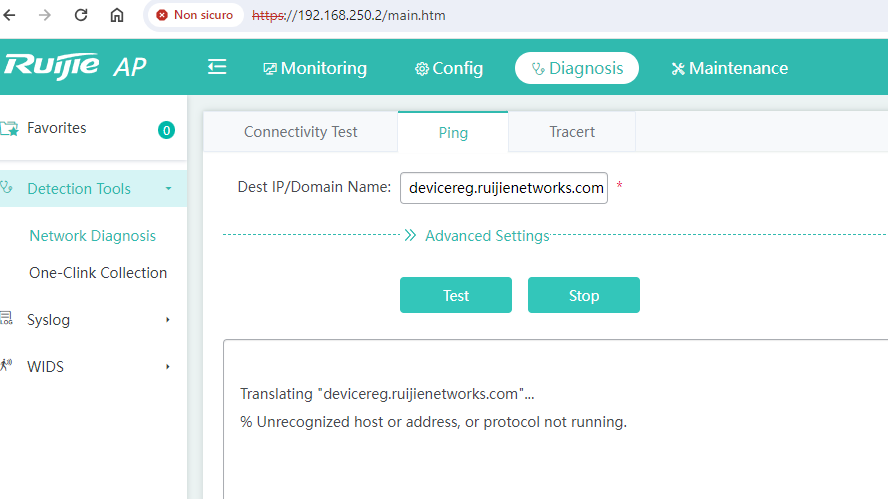

Ciao Jenny,
Ho aspettato una decina di minuti ma niente.
Ecco lo screenshot del ping all'indirizzo indicato:
0 2024-3-20 09:04:09 View all replies
Giulio Leone replied at 2024-3-19 23:12
Ciao Jenny,
Ecco lo screenshot del ping all'indirizzo ...

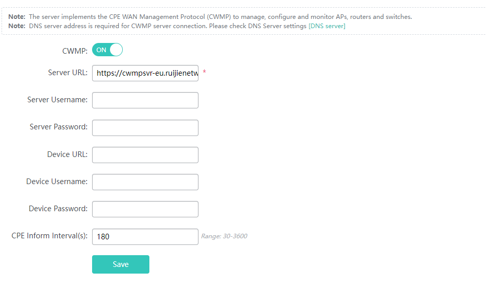

Javier,
Thanks for the reply.
the AP was always in MACC mode, I tried the CLI command but nothing new and the AP is still offline.
So, reading the CLI command I have a question: is it necessary to also enter the CWMP page parameters?

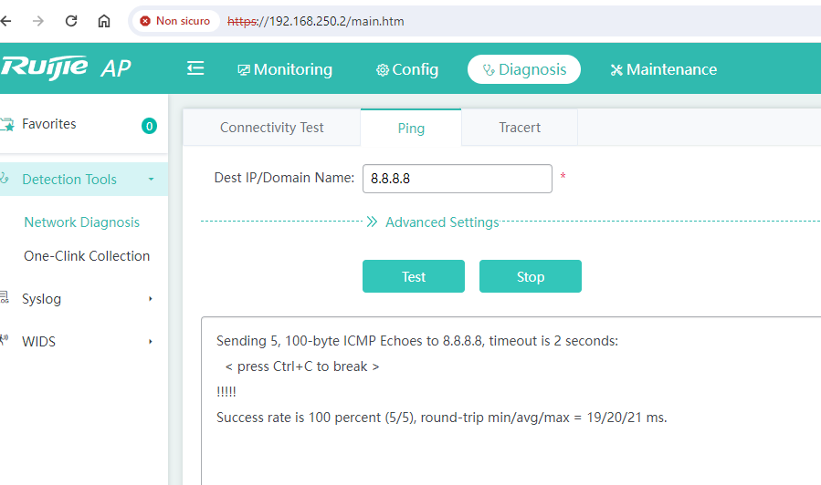

May I know whether your AP can ping through 8.8.8.8? If can, please try to add the DNS server on the AP so that it can resolve the domain name successfully:
config te
ip name-server 8.8.8.8
If the AP even can not ping through 8.8.8.8, please check the Internet first.
For further assistance, you can send your network topology and  the AP complete configuration to our email: service_rj(Ruijie International) <service_rj@ruijienetworks.com> and attach this link to solve your issue quicker. Thank you for your cooperation.
Jenny
0 2024-3-20 15:18:40 View all replies
GTAC-Jenny replied at 2024-3-20 14:40
May I know whether your AP can ping through 8.8.8.8? If can, please try to add the DNS s ...
Jenny,
ping it's good.
