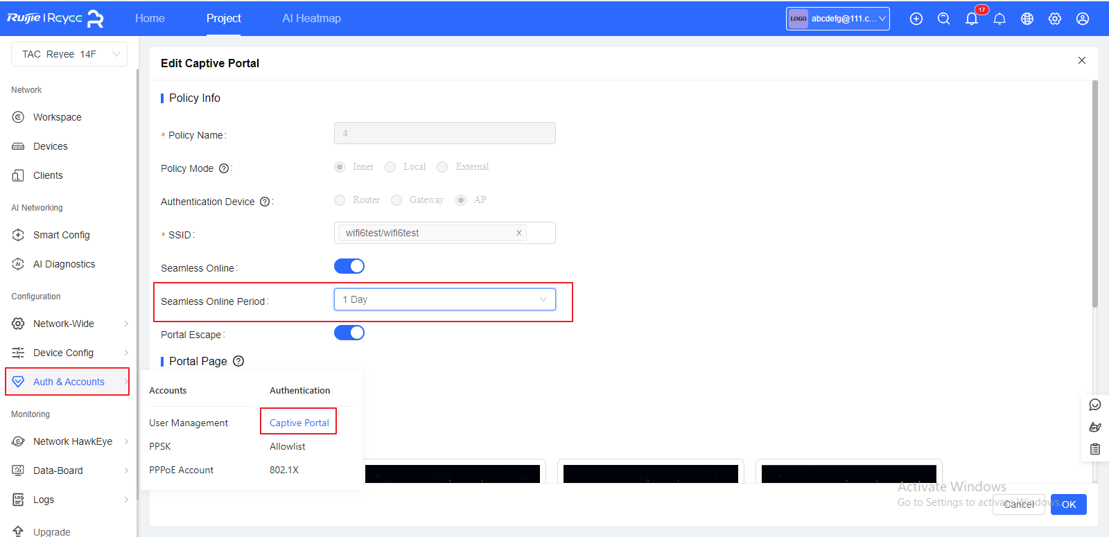

Hello,
I just did the captive portal for one of my clients with the one click method. The thing is that I would like users to login and untill 2 weeks or so they don't have to login again.
I don't know if this is possible.
I've tried to set a duration but it does not work.
Thank you in advance.
Other
Configuration Authentication Router Cloud Other
0 2024-3-22 12:33:38 View all replies
You can try to enable seamless online function on the following page. After the function is enabled, clients in the authenticated IP address segment need to be authenticated only once if they login within the specified time. After the function is enabled, you need to set the time range.
