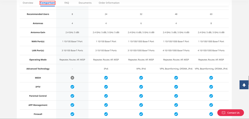

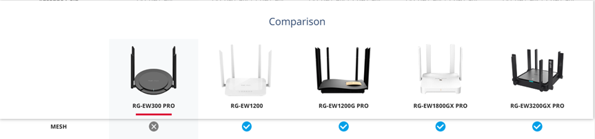

Check whether the main router and secondary router support mesh function or not. This information can be check on the comparison of official product page or the product datasheet.

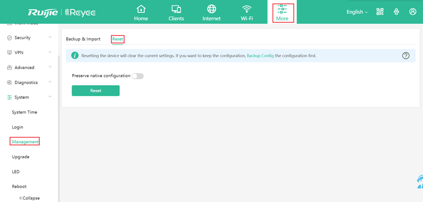

2. When you configure mesh, the main router should complete the initial configuration but the secondary router should in factory configuration. If the secondary router has finished the initial configuration, please reset it on the web or press the reset button with more than 5s.
