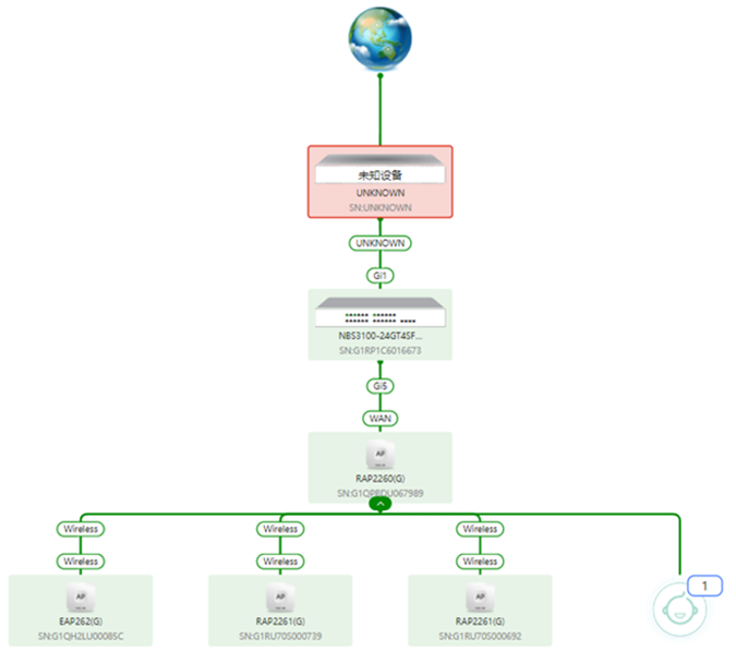

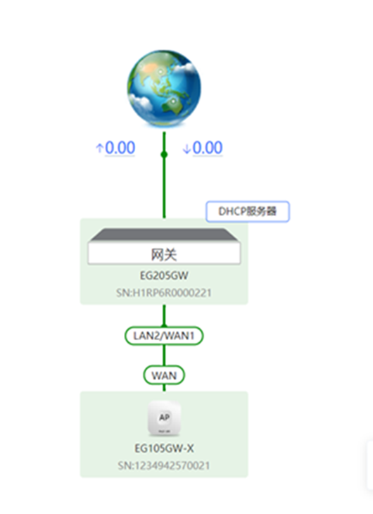

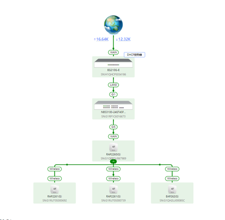

<span style=""">EG as a Master</span>
AP as Master
EGW as Master

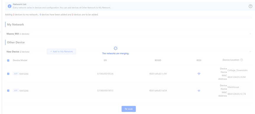

1. Mesh AP can besearched by Master
1.1 The mesh AP is not restored to factory defaults
a) The AP will check whether the network ID of device is empty or not when doing mesh. If the AP has been initialed, the SSID can’t be searched by AP because the network is not empty.
b) The device finished the initial configuration can’t switch the channel automatically, but the device is factory setting will switch the channel automatically.
1.2 The distance of Mesh APs is too far to be searched.
1.3 Check version of the AP and make sure the AP can support mesh function.
