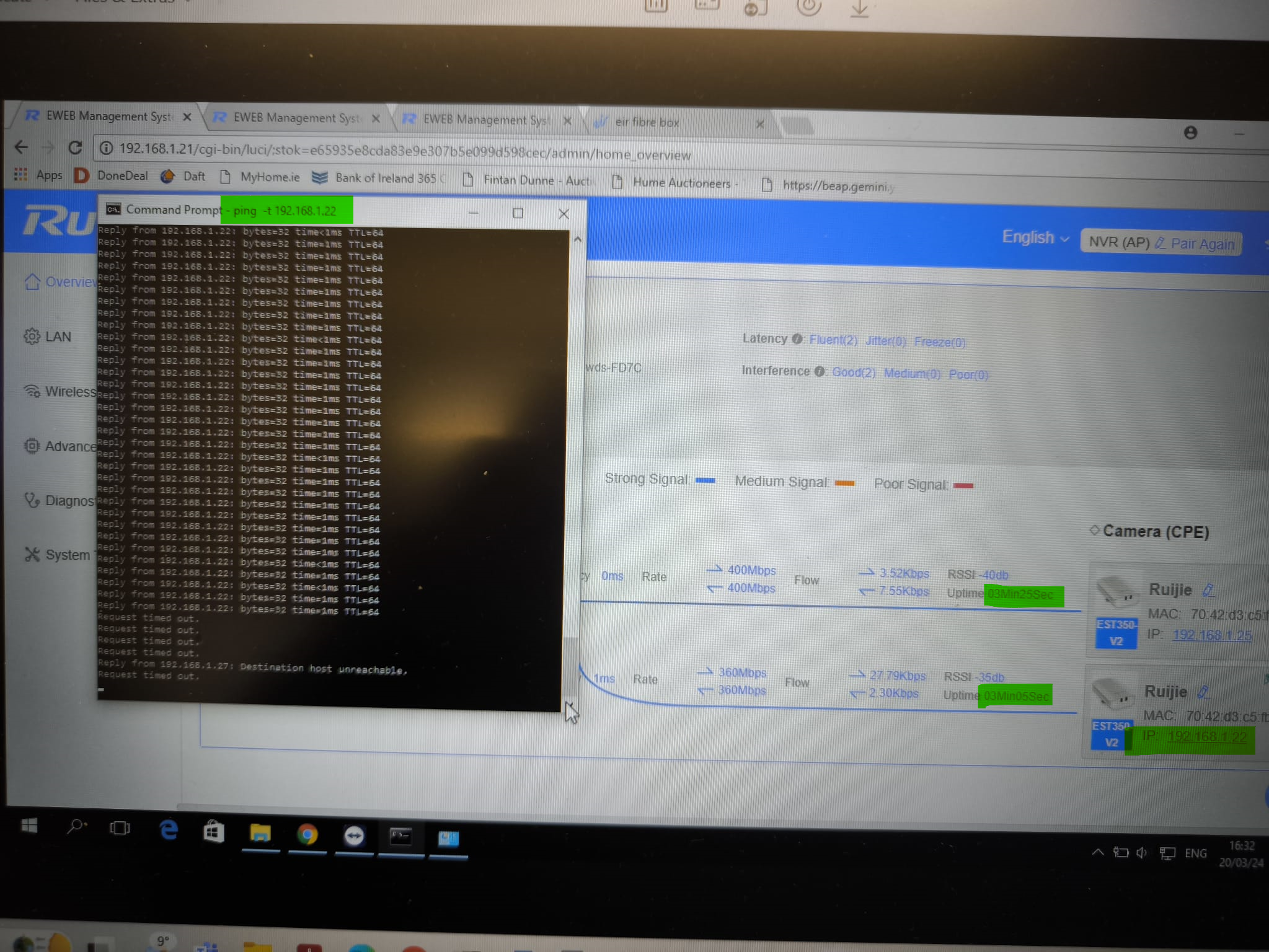

Hi,
See below scenario.
Wireless bridge from House to building A and B. Both buildings in same direction about 250m from AP. Clear line of sight.
I did P2MP by adding additional CPE. All looks fine from technical point of view but for some reason both CPEs disconnecting after 3minutes.
I already tried to:
-relocated antennas
-replaced PoE for all units
-check for interference (used all 3 modes)
-used few frequencies (5180, 5300, 5700, 5800)
-used different channels (20/40/80)
-all reset to default config and stetted up again
P2MP is not online so can not be adjusted by cloud, all changes done with remote desktop on web interface.
Any Ideas ??
RG-EST350 V2
Wireless Wireless Bridge Wireless-Bridge
0 2024-3-21 23:04:35 View all replies
