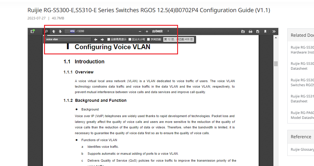

GTAC-Micca replied at 2024-3-25 09:24
For configuration, you can refer to page 469: https://www.ruijienetworks.com/resources/preview/ruiji ...

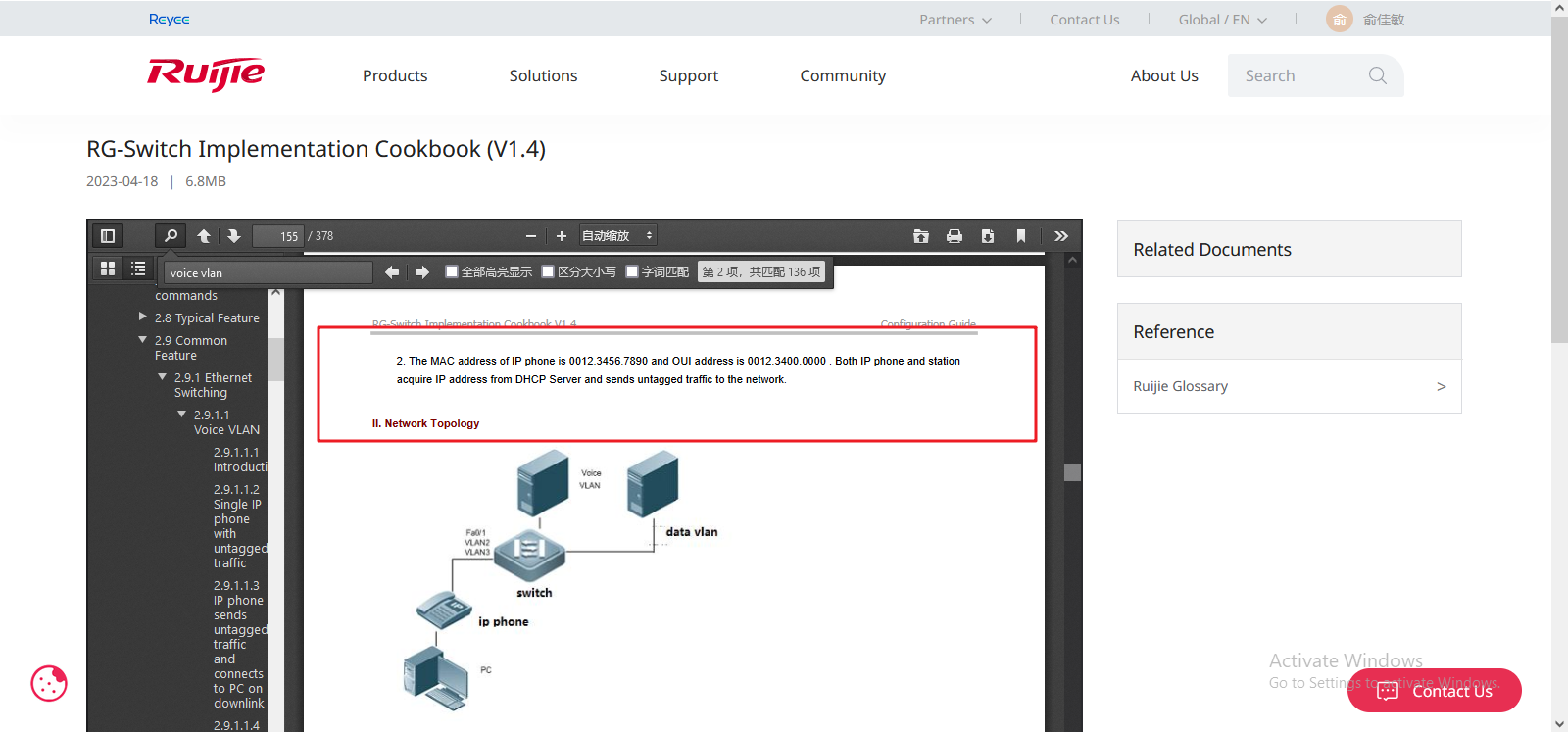

After the IP phone can get the voice vlan IP address, you can configure voice vlan on the IP phone to improve the priority of voice stream transmission and ensure voice quality by transmiting voice streams in the voice VLAN, and configuring QoS specific for voice streams via this guide on page 155: https://www.ruijienetworks.com/resources/preview/75577
