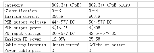

I understand if I have those sources, but what voltage would it be?
0 2024-3-25 20:42:45 View all replies
User 49978 replied at 2024-3-25 20:36
Hi sir,
please refer to this chart.
