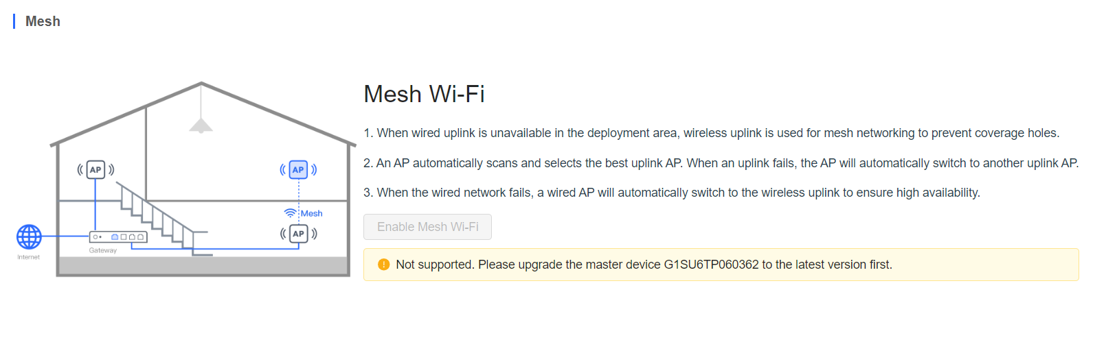

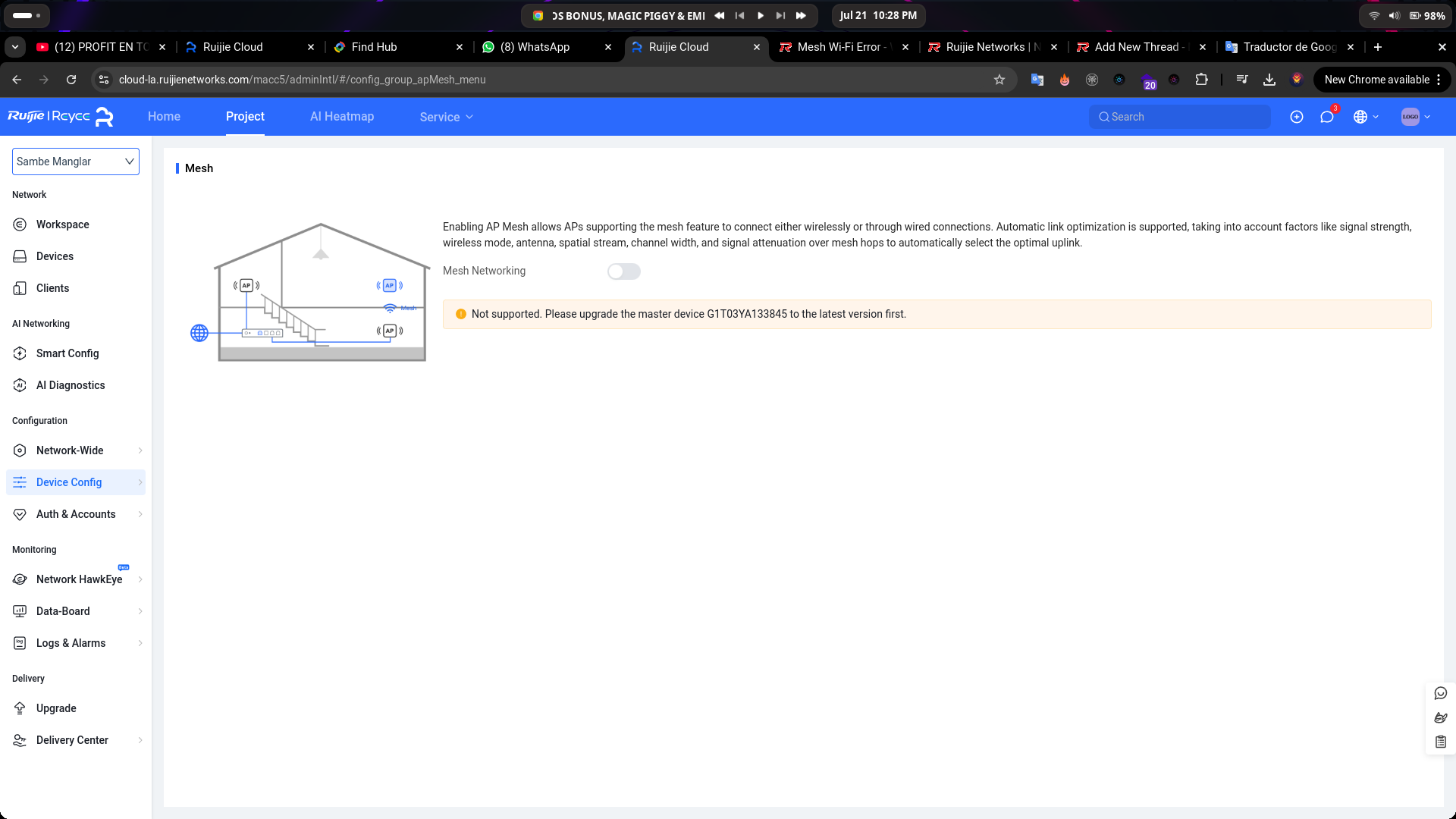

[color=rgba(0, 0, 0, 0.85)]How do I enable Mesh WiFi? Every time I try, I encounter the error message "Not supported. Please upgrade the master device G1SU6TP060362 to the latest version first." However, my devices are already up to date.
RG-RAP2200(F)
Mesh Wi-Fi Wireless

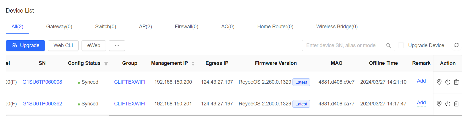

Hello, I followed your instructions, but the issue persists. How can I upgrade the master device? Is it automated or do we need to do it manually?

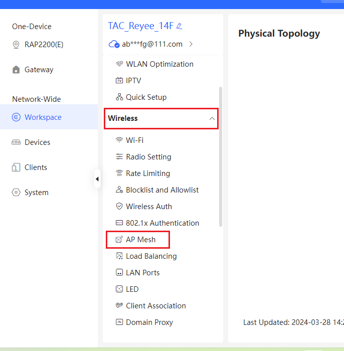

Do you test locally eweb and check whether it can be enabled on local eweb?
0 2024-3-29 14:56:27 View all replies
GTAC-Micca replied at 2024-3-28 17:19

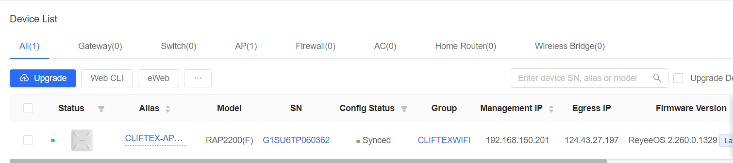

Hello, the option you mentioned is not available on my device. What should I do next?

Dear Feroz Anwer,
Please kindly note that RAP2200(F) does not support Reyee Mesh.

I bought 3 EW1300G and I want to connect them via mesh. So far, they're only used as repeaters. However, when I activate the mesh from the cloud, I get:

Hello,
Can I ask what device model do you have on this project? EW device cannot mesh with RAP devices.

All 3 are EW1300G
At the moment they are only working as a repeater and I want a mesh network.
