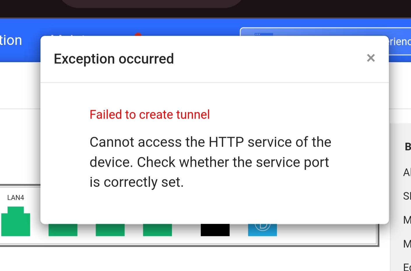

For some reason this gateway started to behave differently.
I can't create tunnel anymore unless I reboot the whole thing. Any idea what went wrong ? And what can I do ? I seem that the new firmware caused this issue.....
Please see attached screen capture.

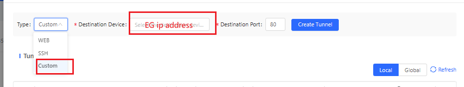

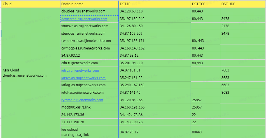

1. You can try to create several times for test.
2. If you have other devices that can create tunnels normally, you can also try to create tunnels for EG using the tunneling features of other devices:
3. If you have a firewall in your network, you can also try to unblock some ports manually and test again
