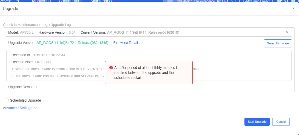

We are encountering an issue while attempting to upgrade the firmware for the AP720-L. Upon attempting the upgrade, we receive the following error message:
"A buffer period of at least thirty minutes is required between the upgrade and the scheduled restart."
We have already restarted the AP before initiating the upgrade, and despite this, we continue to encounter the same error. Could you please advise on how to resolve this issue?
Thank you for your assistance."

The AP is working well, but there is a notification to update the firmware when updating show that error
0 2024-4-3 14:32:03 View all replies

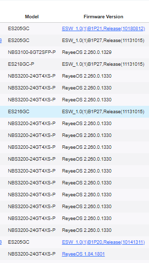

1. Is there a switch being upgraded in your network?
2. Have you tried upgrading the web page of your device?
    Yes, 3 switches have notifications for updates but still get the same error message,
   Which web page device?
0 2024-4-5 09:22:43 View all replies
John S replied at 2024-4-4 08:21
1.Can you try to stop the upgrade of switch and then try to upgrade the AP again?
