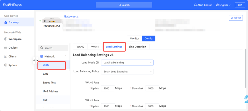

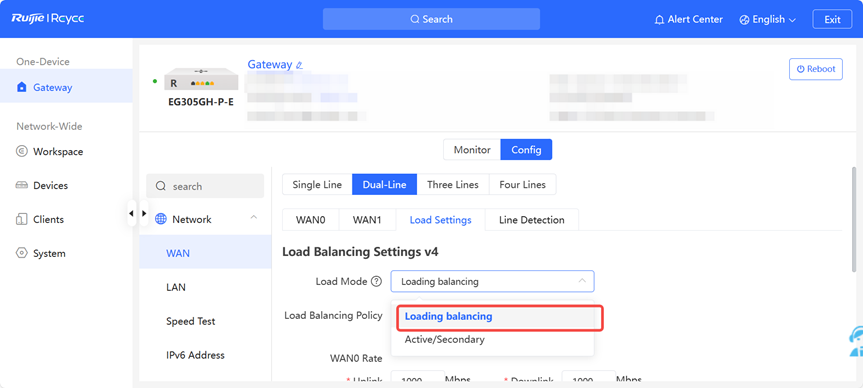

1. Enter the eweb of Reyee EG
2. Select Network > wan > load setting

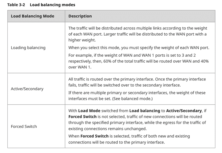

Here is the difference between three load modes:

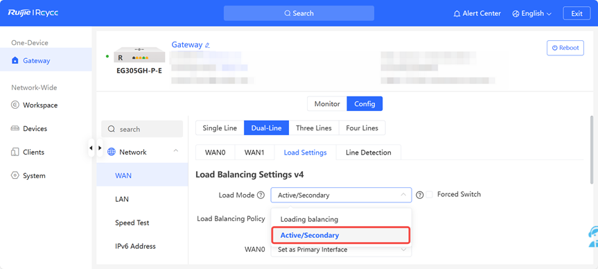

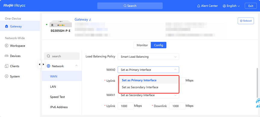

To use active/standby mode, please select Active/Secondary mode like this:
Note: During the process of switching from the secondary interface to the primary interface, the secondary interface flow is forcibly disconnected, and all flow is switched to the primary interface! If the traffic hits the backup line of other types of routes, it may be discarded and cause disconnection.
4. For  Active/Secondary mode, you can designate primary and secondary interfaces for different WAN ports.
5. To use load balancing mode, please select Loading balancing mode like this:

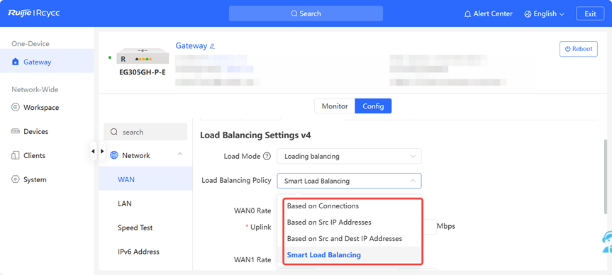

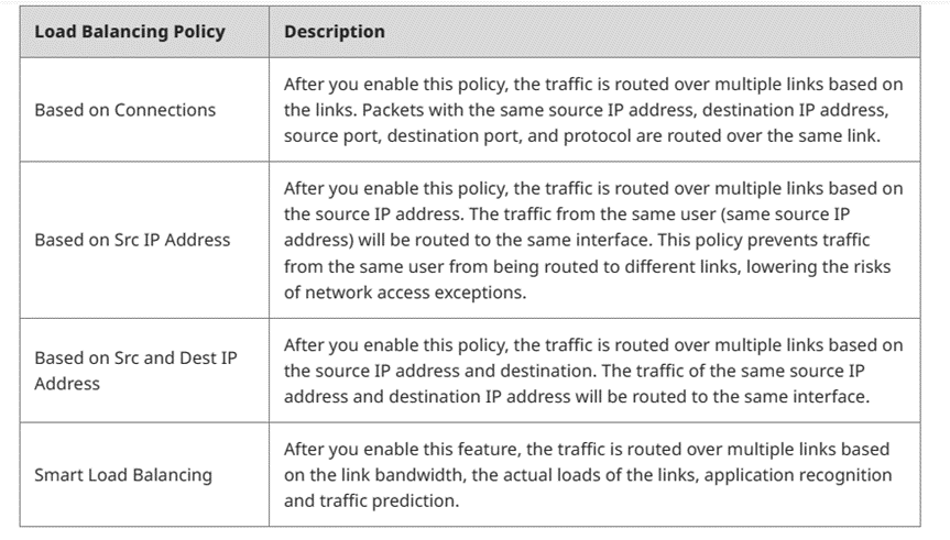

6. There are 4 different load balancing policies to choose. Here is their meaning:
