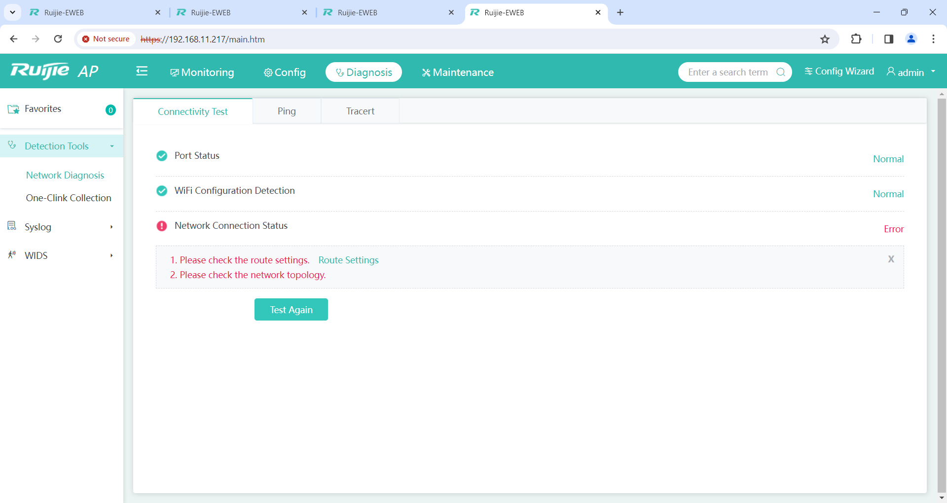

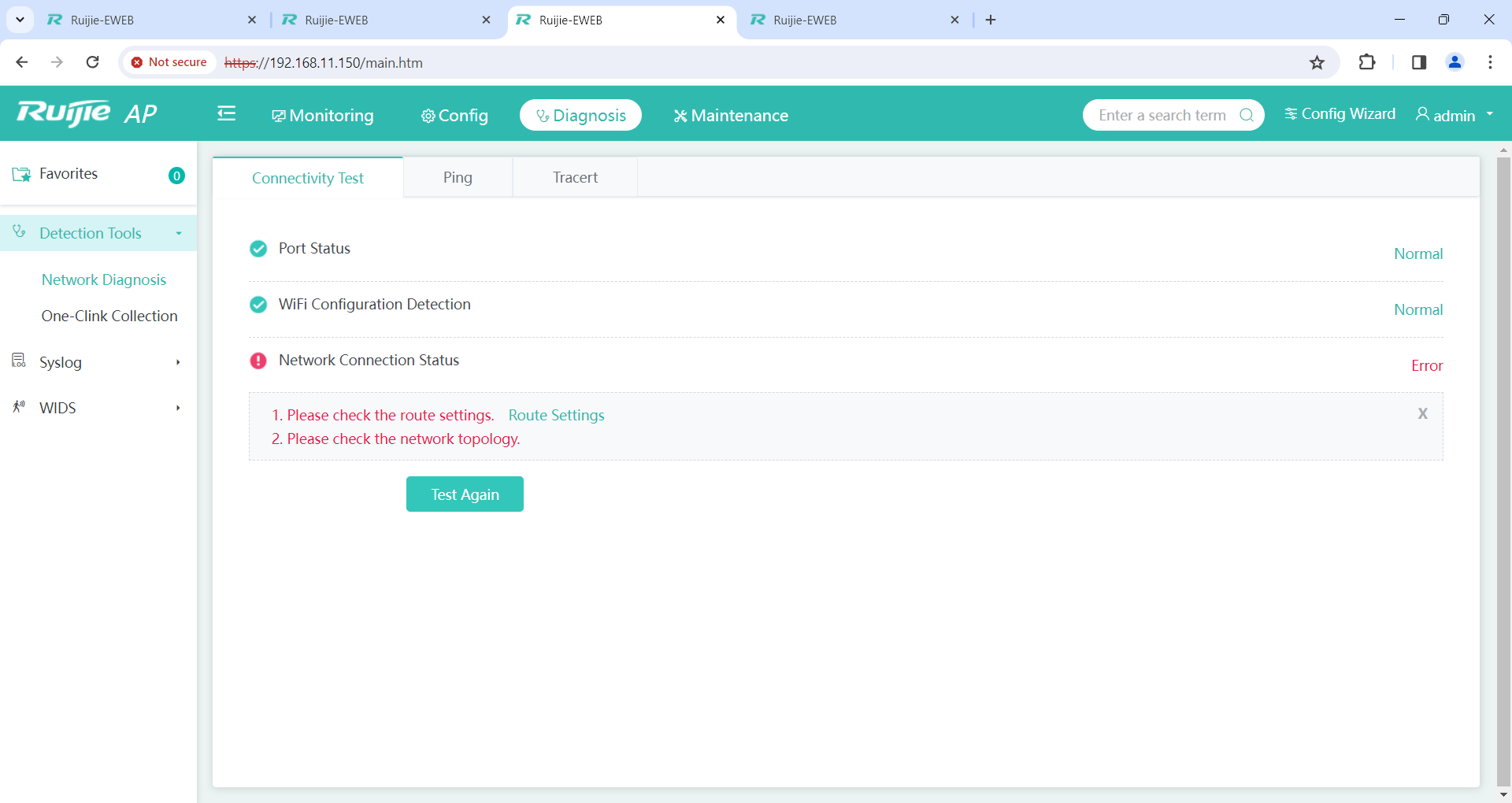

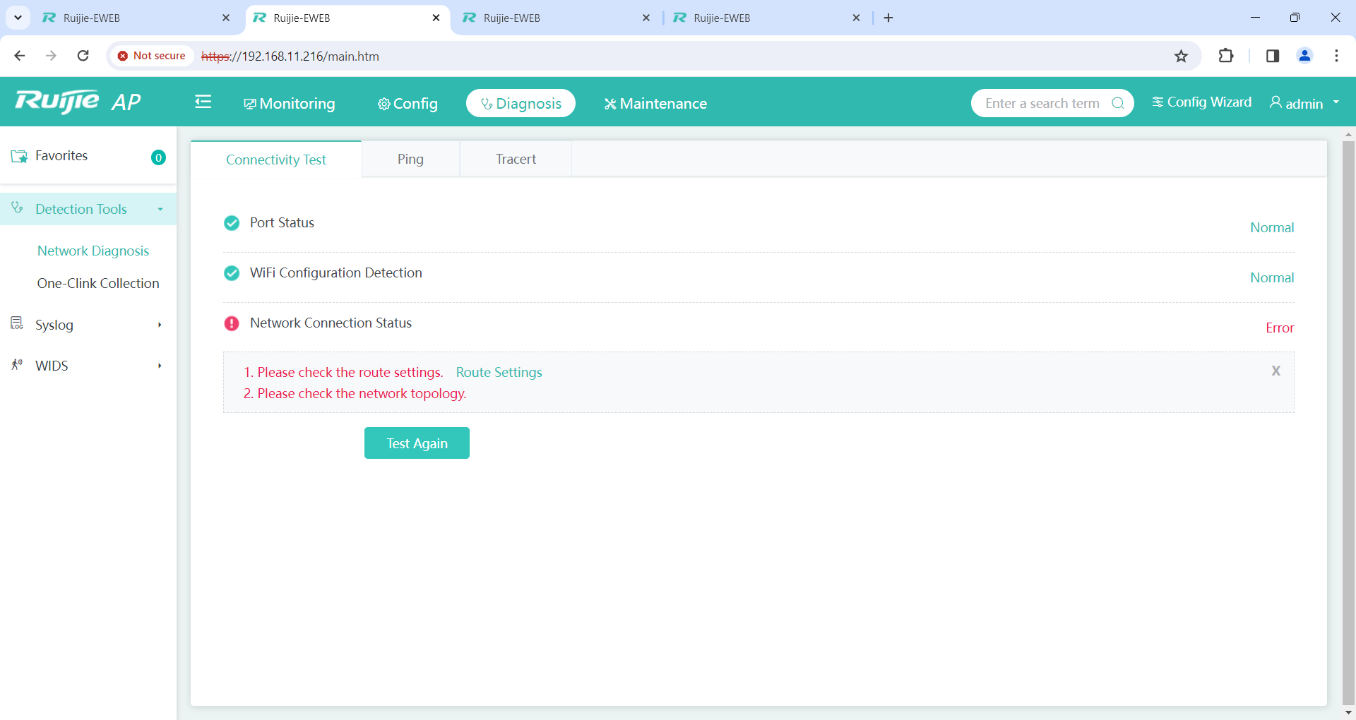

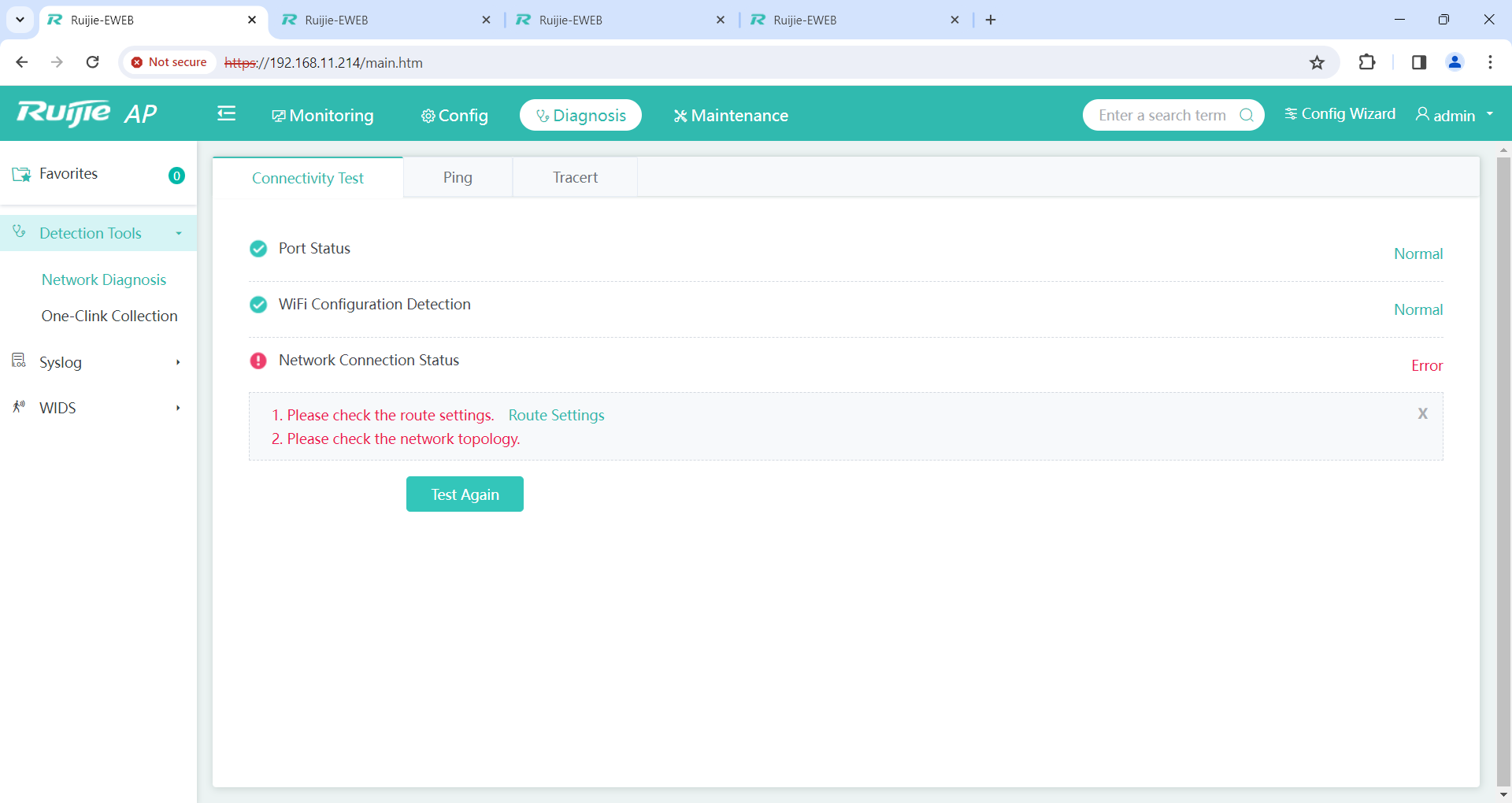

I've performed Diagnosis in WiFi AP web interface, found error in "Network Connection Status", PING the external IP/Domain Name but 100% Success Rate (8.8.8.8 / 1.1.1.1 / apple.com)

The error in Diagnosis can sometimes be inaccurate, as long as the ping test including ping 8.8.8.8 or ping google.com results are correct then you may ignore the error in AP network diagonosis.

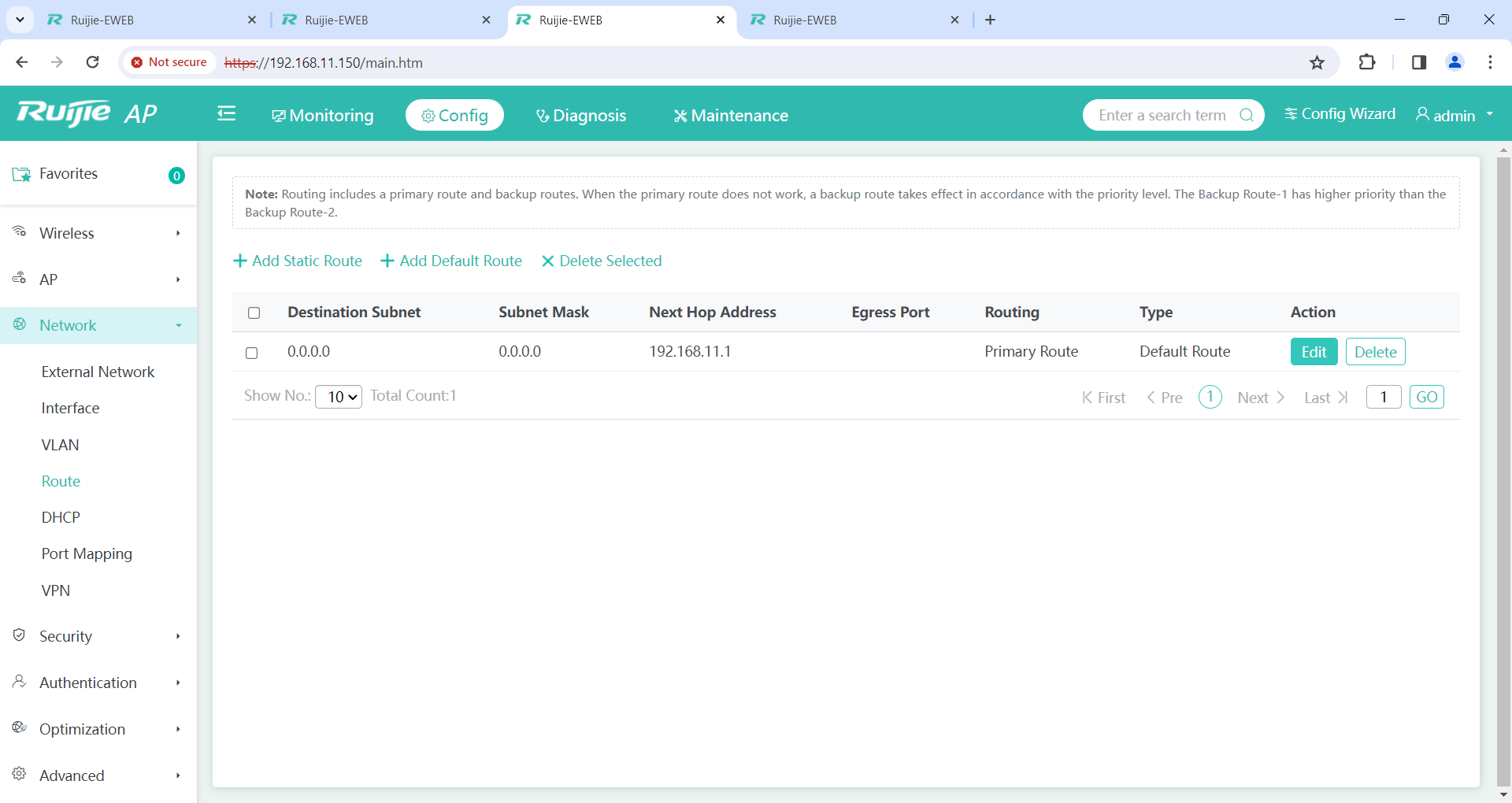

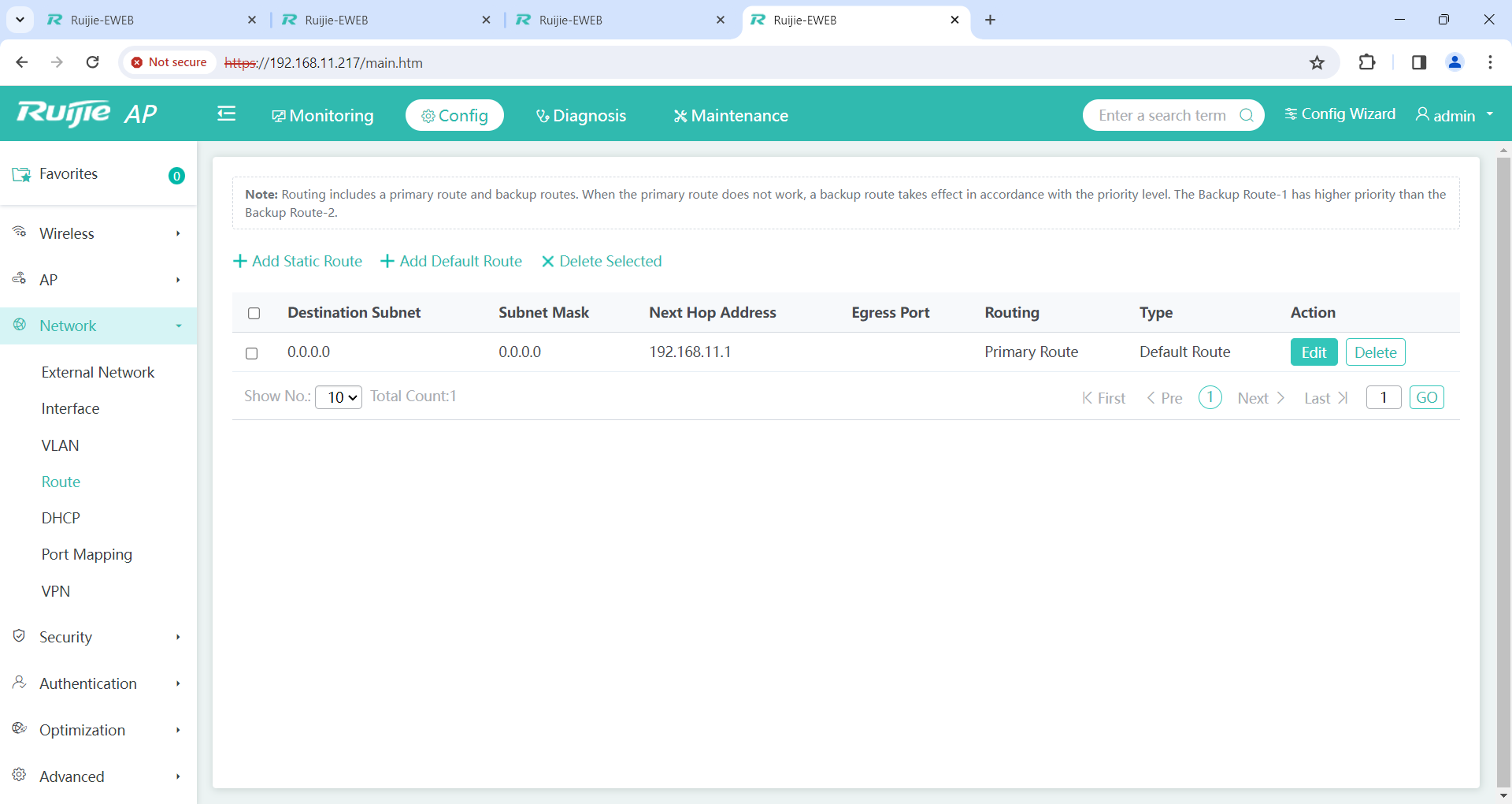

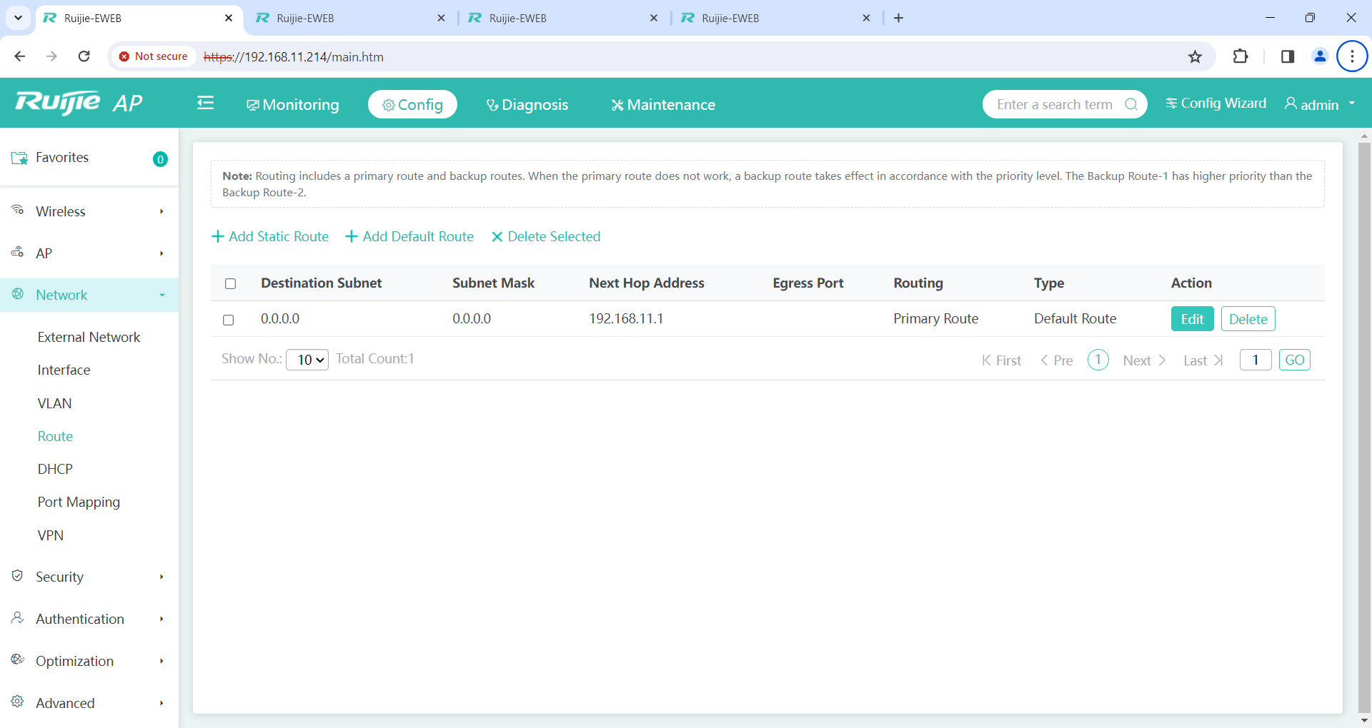

Question 2) all APs configured as Static IP, I run your given code in Web CLI and return message below
even I have my Mobile Phone connected to APs 192.168.11.214:

WiFi-AP-GF-Office#show ip interface brief
Interface                                IP-Address(Pri)      IP-Address(Sec)      Status                 Protocol
BVI 1                                    192.168.11.214/24    no address           up                     up
BVI 200                                  192.168.200.214/24   no address           up                     up
WiFi-AP-GF-Office#
WiFi-AP-GF-Cafeteria#show ip interface brief
BVI 1                                    192.168.11.216/24    no address           up                     up
BVI 200                                  192.168.200.216/24   no address           up                     up
WiFi-AP-GF-Lounge#show ip interface brief
BVI 1                                    192.168.11.150/24    no address           up                     up
BVI 200                                  192.168.200.150/24   no address           up                     up
WiFi-AP-GF-Lounge#
WiFi-AP-1F-Office#show ip interface brief
BVI 1                                    192.168.11.217/24    no address           up                     up
BVI 200                                  192.168.200.217/24   no address           up                     up
WiFi-AP-1F-Office#
I've also test the "ip address dhcp" command in existing VLAN interface in APs but the connecting Mobile Phone/Laptop still unable to be connected (no IP granted)
