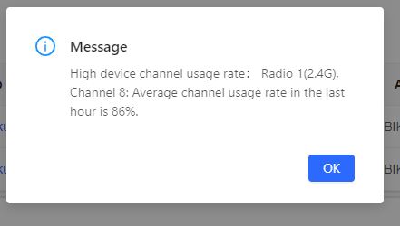

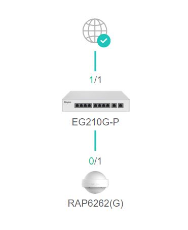

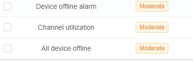

I face an issue related with my access point frequently goes online and offline. How to fix this issue?
RG-RAP6260(G)
