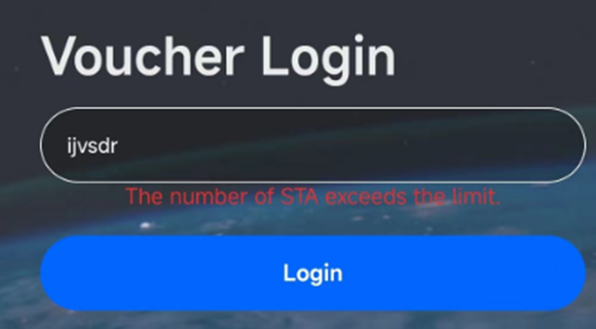

Fault Phenomenon
When enter the voucher/account, show ‘The  number of STA exceeds the limit'
Troubleshooting Steps
1. Check whether the number of users of the account/voucher is limited to 1 and other users have been bound to the account. If yes, you can do following three ways to solve it:

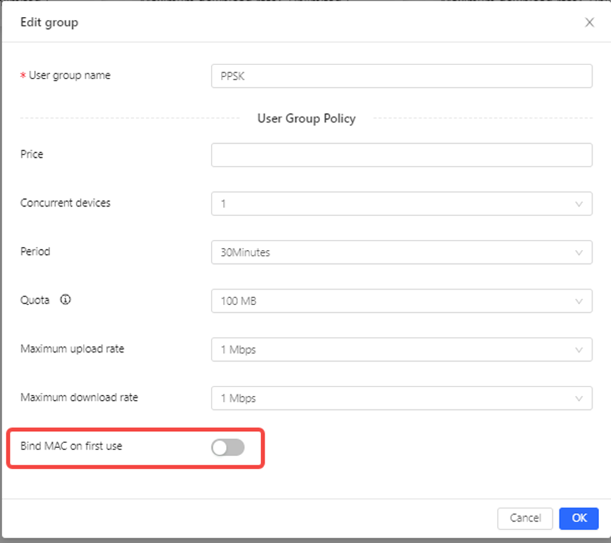

(2) Cancel the Mac bing for the first use

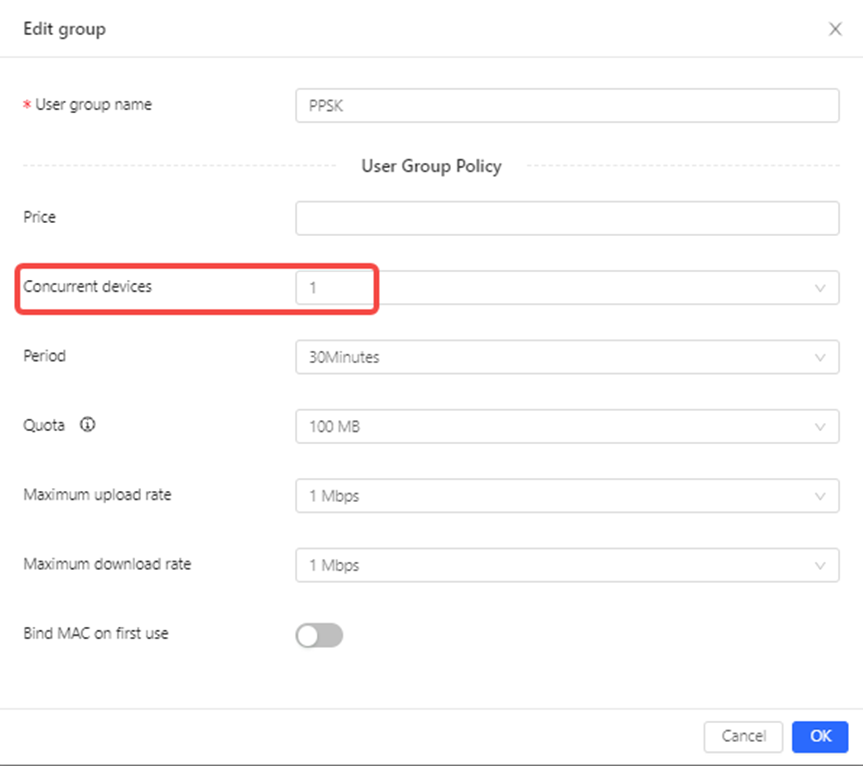

(3) Modify the concurrent devices. You can set "Concurrent Devices" based on your needs
