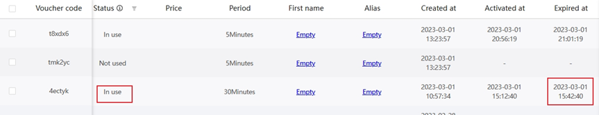

2. Fault Phenomenon
The period is expired but still can be used.

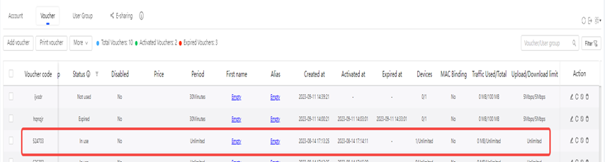

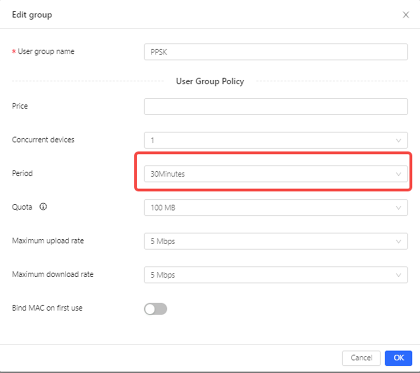

(2) Check if the user has configured period limit

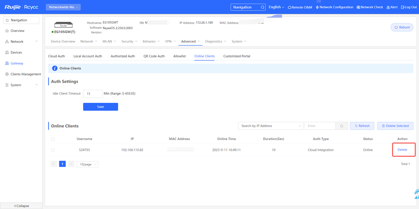

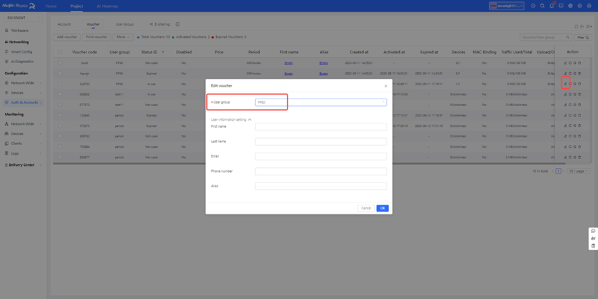

If the product doesn't limit the period,which means the voucher or account band an incorrect user group. Please kick the current user offline and create a new Voucher or Account for the current user, or modify the current Voucher or Account to bind to the correct user group.

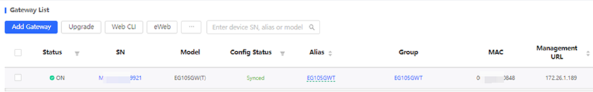

(3) Check if Reyee EG is online properly.
If Reyee EG not online on Ruijie Coud, the device configuration can't synchronize to Ruijie Cloud successfully. Please follow this guide to troubleshoot this problem:How to do when Reyee devices cannot go online on the Ruijie Cloud? - Switch - Ruijie Community (ruijienetworks.com)

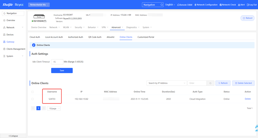

(4)  Check whether the authenticated user‘s online status.
lf the user's period limit configuration iscorrenct, but the user still shows “online” status after the limited time, please contact Ruijie TAC support for help: RITA (Ruijie Intelligent Technical Assistant)
