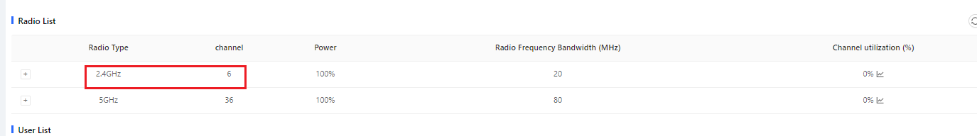

1. Please confirm how far you are from the device. Its wifi coverage radius is 30 meters. If you're too far away, test closer.
2. If you were near the device during the test, log in to the device to check the power configuration. I've attached screenshots of cloud and web respectively for your review. If the power is too low, you can try turning it up appropriately.

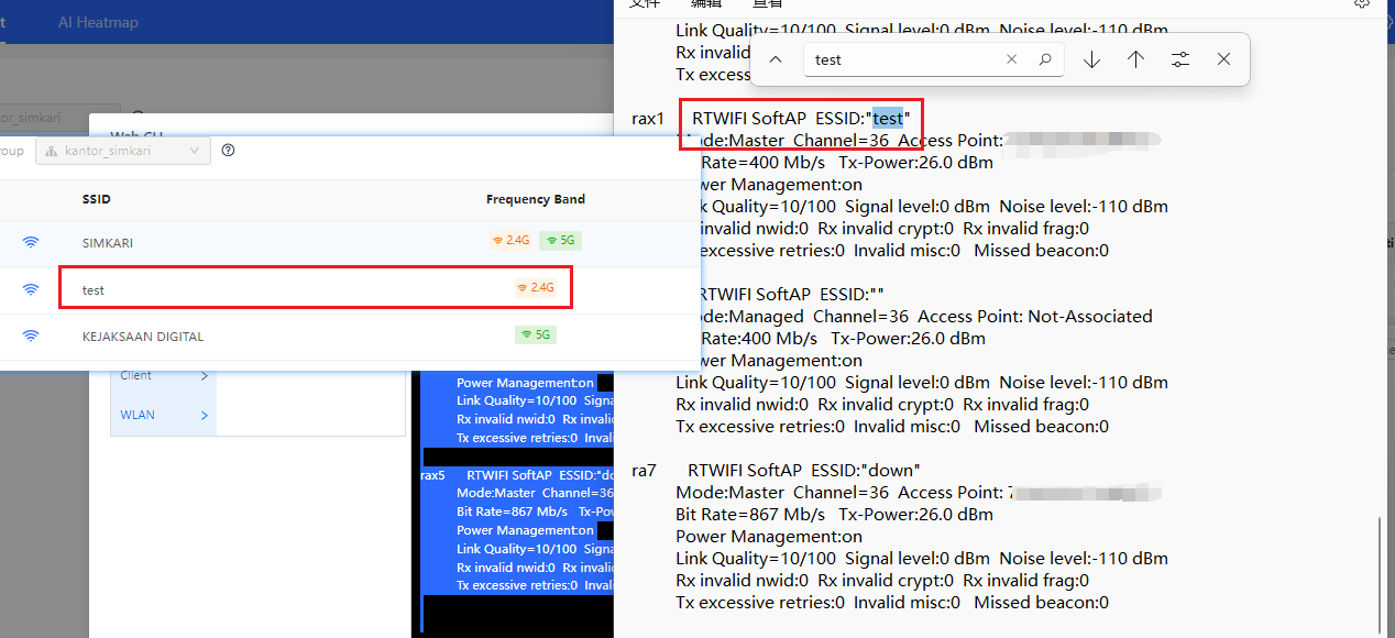

when try set wifi4 mode signal "test", channel is 36 wifi5 mode.

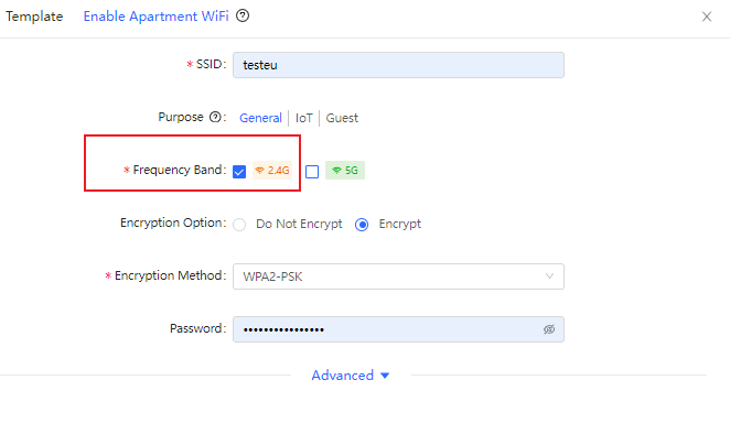

1. If the device does not broadcast the 2.4G SSID, can you check the configuration? Did you select the 2.4G frequency band?
2. Can you create a 2.4G ssid and test it?
3. Is it possible to reboot the device and check?
If the issue still exists, please help to collect the result of the test screenshot and talk with me again. I would be glad to help you in Community.

i did at all,
share project link sent to U'r mail, please check

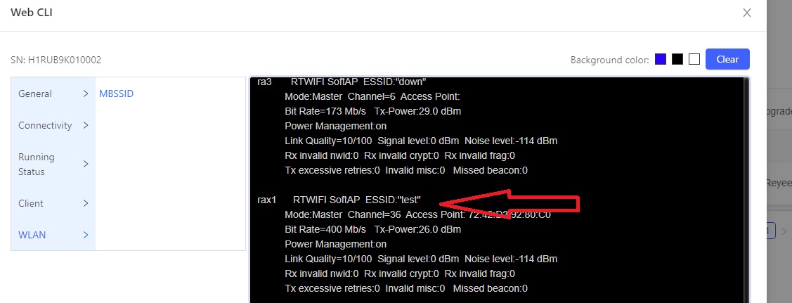

Thank you very much for sharing, I have received the network.
After checking, the device actually uses channel 6 of 2.4G. However, I found that after you configured 2.4G, MBSSID in the cloud shows channel 36. This may be the reason why the device cannot broadcast the 2.4G SSID
We tried to configure it on a local device, but the issue did not recur. Can I request you to share the project with write permission? I need to ask our R&D to check this problem.

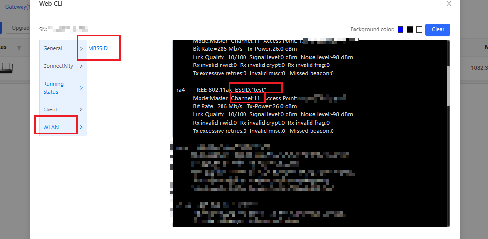

I'm sorry for the inconvenience caused by this issue. Current R&D has examined and provided a solution. R&D will add commands in the background of the device, after which the device needs to be rebooted.
Can I know when the device will be rebooted? In this way, I can make an appointment for R&D and ask him to help me add commands. Then I can reboot the device from web for you.

2.4G on air again- test succesfully, thanks for U'r & Tim help, thank U very much
