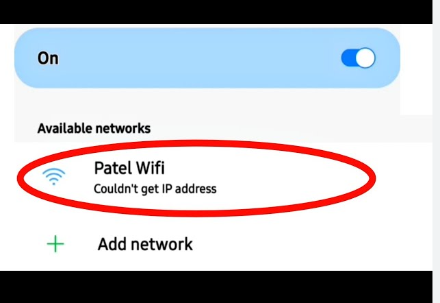

I bought 6 APs RG-RAP2200E. I setup 5 wired APs, and 1 mesh AP. 5 wired APs operate normally, but client can't get IP when connect to AP mesh. Because couldn't get IP, client automatically roaming to another wired AP.
Mesh AP has received IP for itself, i used vlan per SSID
Has anyone got this issue? How to fix it?

Hello Steve,
The client-Android phone just show "Couldn't get IP Address" look like this:
Mesh network has been established because mesh AP got IP for itself as I said above
