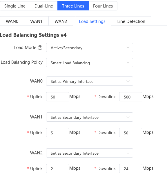

EG310GH-P-E (Reyee OS:            2.260.0.1331)
I have three WAN connections
two VDSL 50/5 , 24/2 and one fiber 500/50
When I use the two VDSL all is OK
When I use the Fiber 500/50 alone or in combination with the other WANs the Internet speed locks at 50/5
with any possible combination of Load Mode and Load Balancing Policy
In some tests after changes I got for a second
download speed 90-120 and once 260 and went back to 50/5.
I have tried everything that could help

Dear Philippos Koukoutsis,
Current Step:
Regarding this case, are you referring to the speed test result locked at 50/5 while setting the rate limit on WAN0 is 500/50 ? Could you also show us the speed test result here ?
Next Step:
Please also try disconnect WAN 1 and WAN 2 and test speed with WAN0 connected only to verify if the rate limit is taking effect.
In case the rate limit is working with WAN 0 alone, please share the project with me to my email accounttaizhaolong@ruijie.com.cn for further investigation.
