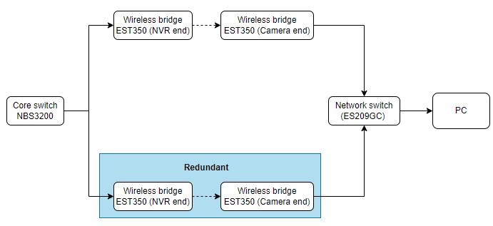

In my planning, I am considering adding a new pair of wireless bridges for redundancy in case the first pair of wireless bridges fails. Would there be any issues if I power on both pairs of wireless bridges simultaneously?

Hi sir,
Sorry for the inconience, it cannot support Redundant for EST, if you use same vlan,  it will form a loop, If you use different vlans, it is equivalent to different EST cameras that cannot be managed, and can not meet your needs.
Steve
