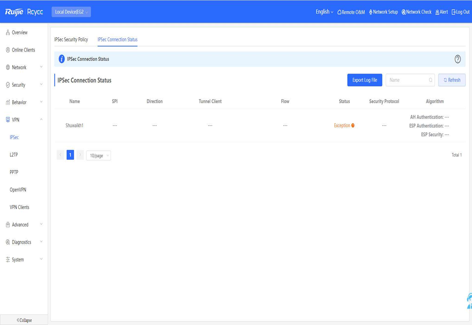

Fault Description
the IPsec connection status is displayed as"exception"

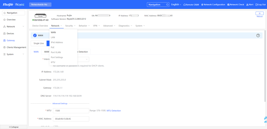

EG can’t access the network or HQ EG is deployed on layer-2 NAT environment.

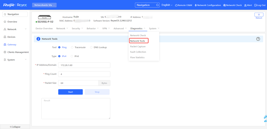

(1) Please check that the HQ EG can be ping successfully by branch EG and both EGs can ping the external network IP (8.8.8.8).

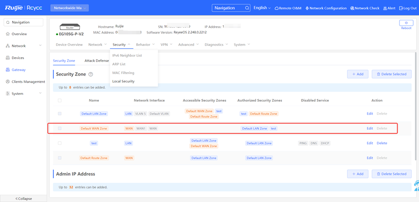

Please make sure that the ping service is enabled on HQ EG.
If the EGs fail to ping the external network, please check whether the WAN port configuration is meet the requirements of uplink network. For example, you can check the account and password of PPPOE are corrent or not? Whether it's need to configure VLAN TAC. Please contact ISP to check the network.

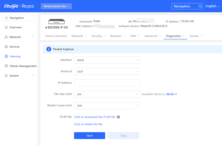

Draw a package on EG to check whether the EG normally sends and receives packets. If packets are sent but not received, you need to contact the ISP to check whether the uplink device releases the IPsec VPN UDP port 500 and UDP port 4500.
