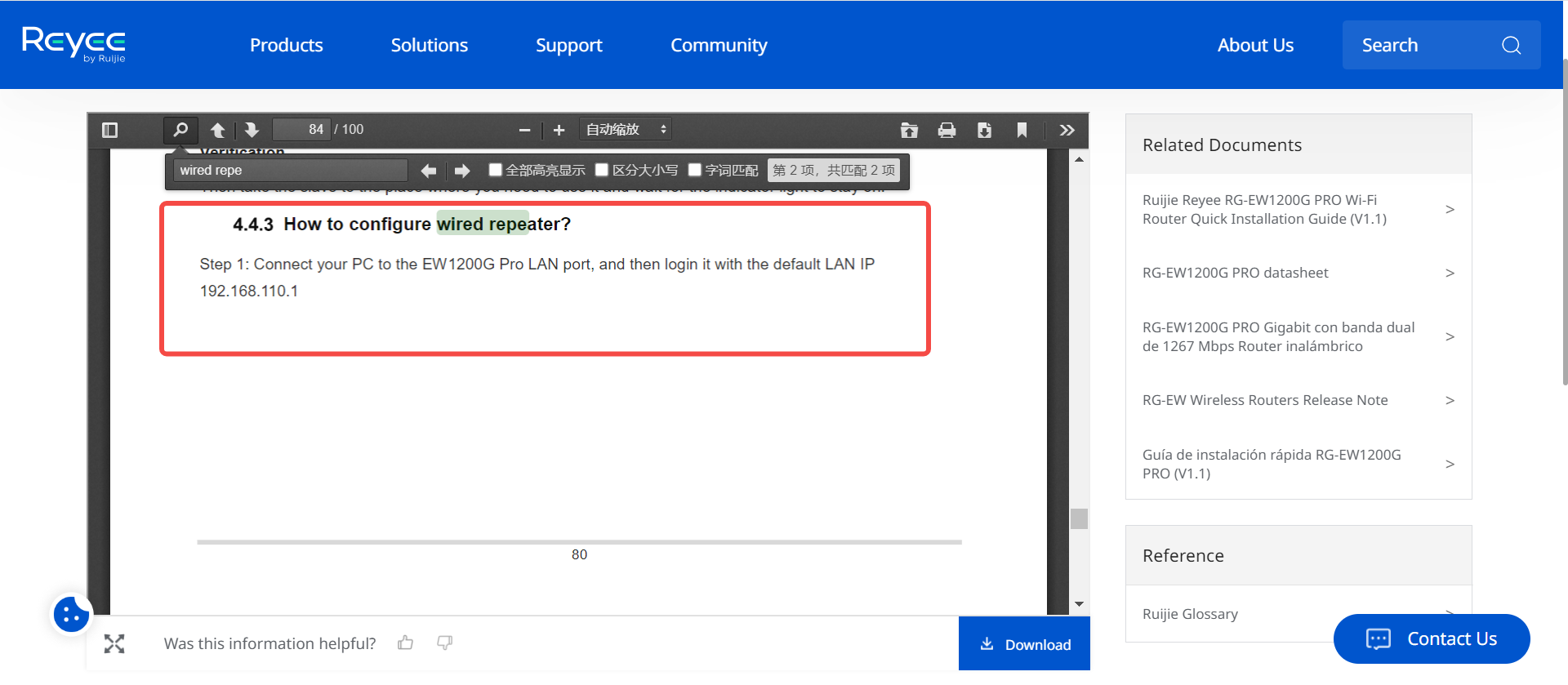

If you need the ISP work as the DHCP server to assign IP addresses to all of users, you can set all EW1200 as the wired repeater mode; otherwise you can settle one EW1200 as the router mode and others as wired repeater mode.
You may refer to the page 84 of the below document on how to configure wired repeater on EW1200
https://reyee.ruijie.com/en-global/resources/preview/mesh-wifi-knowledge-base
The EW1200 would mesh automatically after wired repeater with each other is completed.
