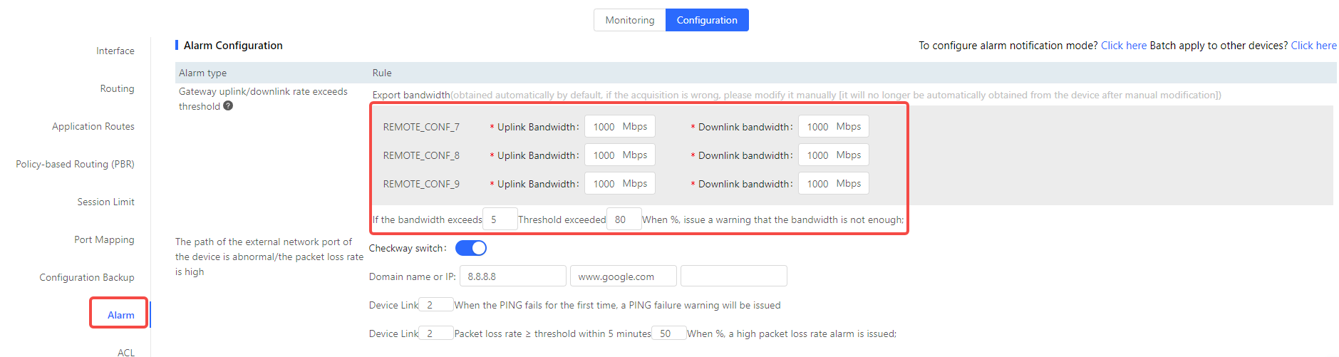

Hi Jay,
The differences between the 3 detections are as follows:
1. Link detection checks the connectivity of a WAN link to the internet, if a WAN link fails to access internet, you can configure link detection on the following page:
If the public domain or IP configured for Link detection cannot be accessed successfully, the Link detection will raise an error and indicate that the WAN link is down.

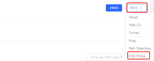

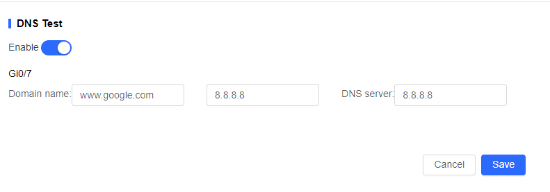

2. DNS detection similarly detects connection to DNS servers, which are used for domain resolution, failure to access DNS servers may cause the users and devices to fail to browse websites and access services on the internet. Unfortunately Reyee EG does not support DNS probe at the moment, if you have a Ruijie EG, you can configure DNS probe as the following:
3. Bandwidth Detection can check whether the traffic passing through a WAN interface is reaching a pre-defined threshold, and raising an alarm if the limit is exceeded. Unfortunately Reyee EG does not support this feature at the moment either, if you have a Ruijie EG, you can configure Bandwidth threshold as the following:
Jayden
