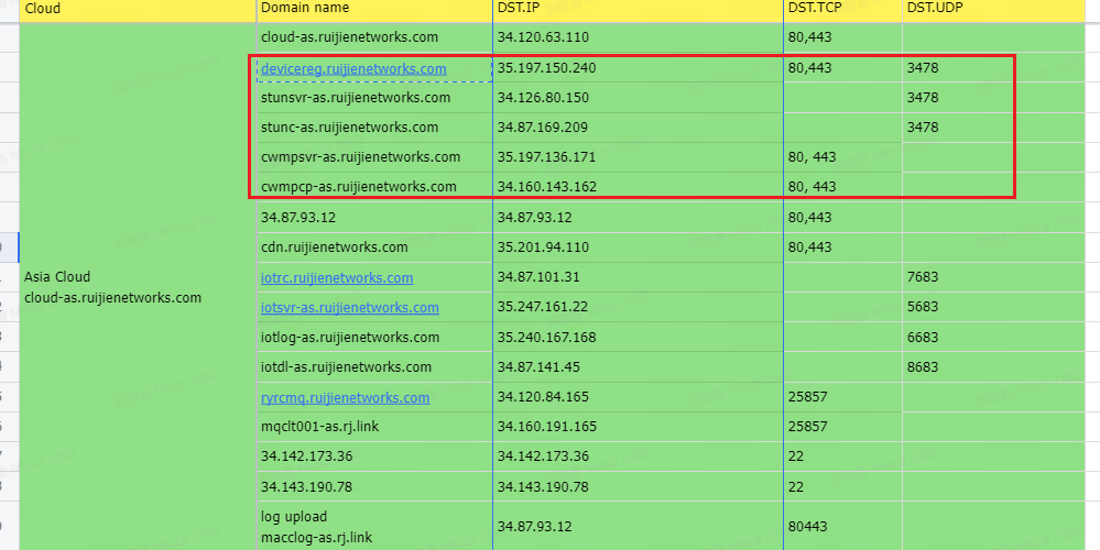

1. What was the previous version, and from what version to the current version
2. May I know what device is your uplink gateway? Is it a firewall? Or any modem with firewall function?
If yes, you need pass these ports and domains:
Note that if it is not manually added to the list that is released, it is blocked by default.Release in both the outgoing and incoming directions.
*Please note that the above sharing is based on the location of your community (Country/Region: India) if the location is not the location of the device, or is not the cloud host you are using, please let me know.
If the issue still exists, please help to collect the capture packet information and talk with me again. When capturing packets, click Manual delivery on the cloud.
Please share the capture packet with me. I would be glad to help you in Community.

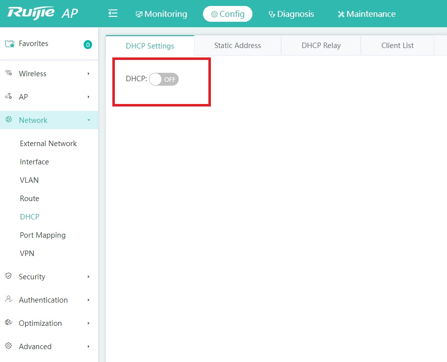

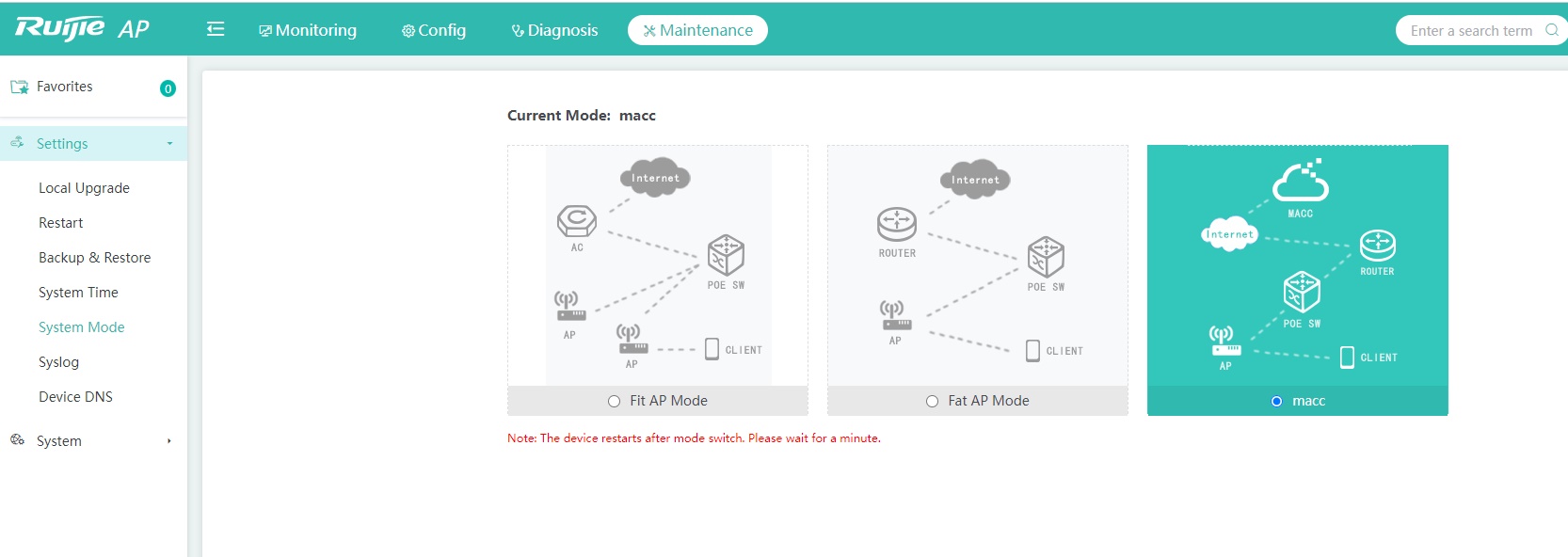

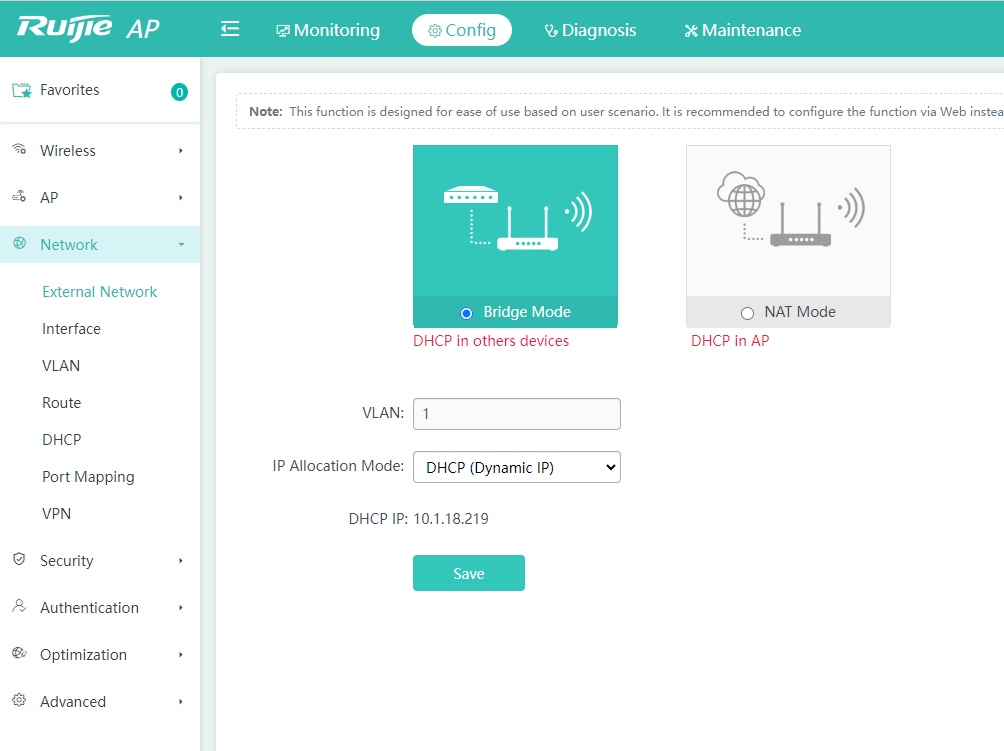

DHCP Note assigned to user by AP itself, because DHCP automatically turns off when it restarts if any power goes out, so IP obtaining failed to User Mobile, We attached our setting screenshots; please give the solution.

2. About the problem that DHCP automatically disables. Can I know if all APs have this problem?
