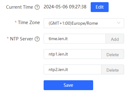

Good morning,
I configured my time (GMT + 1) europe/rome
the time is error because the correct tile is 10:27 NOT 09:27
How sync correctly time ?
RG-RAP2260(E)

Hi sir,
This is the system time, which is calculated in UTC/GMT +1 hour (Zone 1 East). I checked that the Summer time in europe/rome has been moved forward by 1 hour and the current time zone is UTC/GMT +2 hours. So you can change it to UTC/GMT +2 hours.
Steve

Hi Steve
in Italy there is a summer time GMT+2, in this moment, but in AP System , System Time, there isn't an option summer time.
What I should do is choose a time zone that is not Rome, but this then needs to be changed, manually, every time summer time ends.
Is there no other possibility with an option for the summer?

Hi wallnas,
The issue is expetced to be fixed by next version of AP in July.  During this period, it is advised to change the time zone manually to avoid the issue.
We are really sorry for all inconvenience aused to you.
