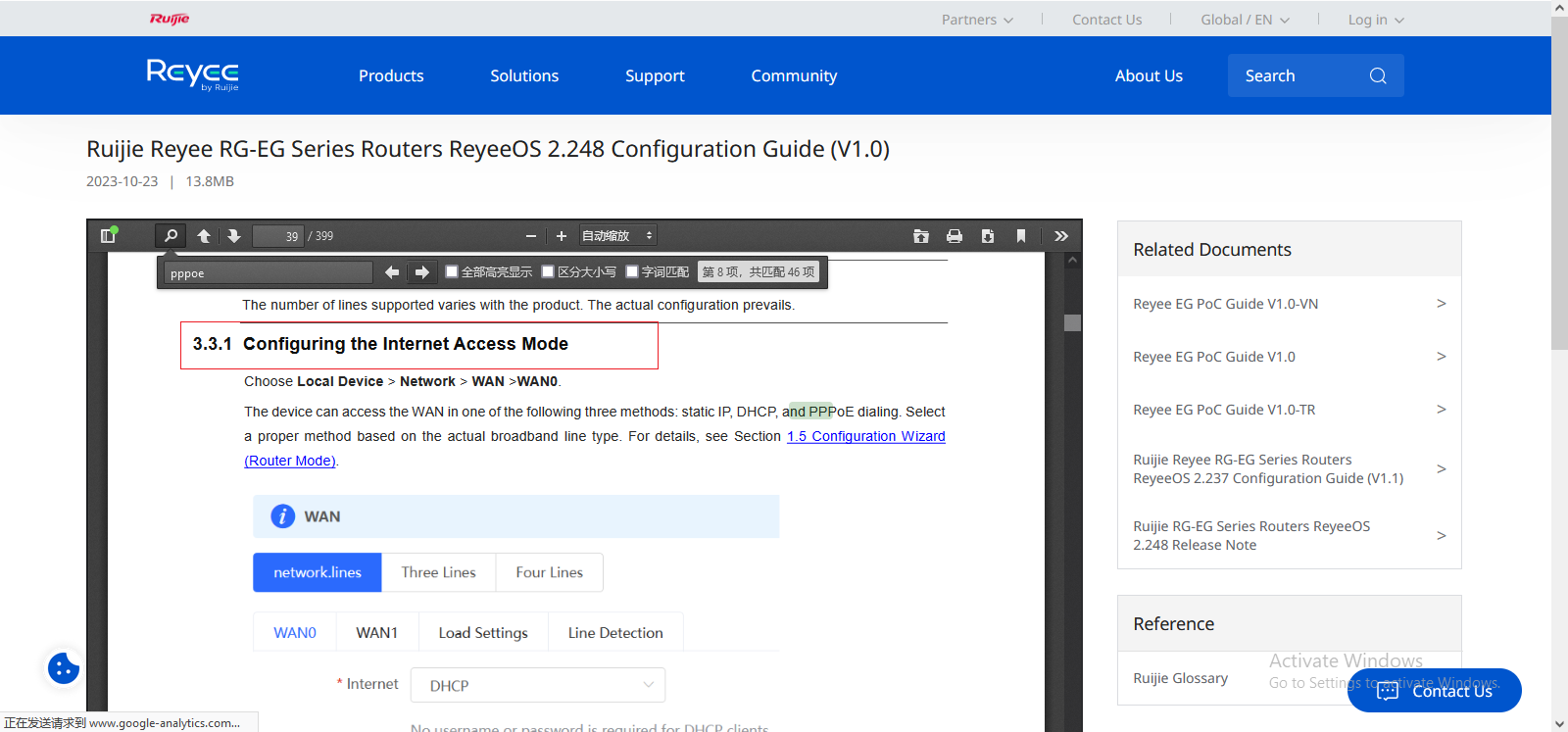

Please help check whether the EG itself can access the Internet normally and whether the PC can get IP address when connected to that network. If the EG itself has Internet issue, you may need to finish the WAN settings on the EG via this guide on page 39 first: https://reyee.ruijie.com/en-global/resources/preview/ruijie-reyee-rg-eg-series-routers-web-based-configuration-guide-release-reyeeos-2-248-en
If the problem still exists after you done the WAN settings, please help test by trying to directly connect to the tplink router to see whether it can get IP address and access the Internet. If the PC still has the same issue, you may need to check on the tplink router side settings.
