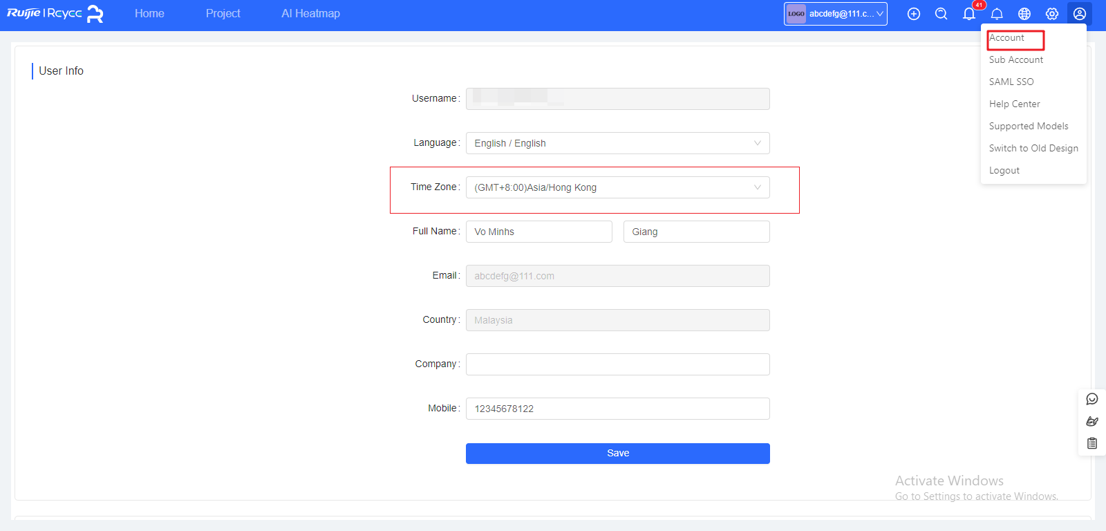

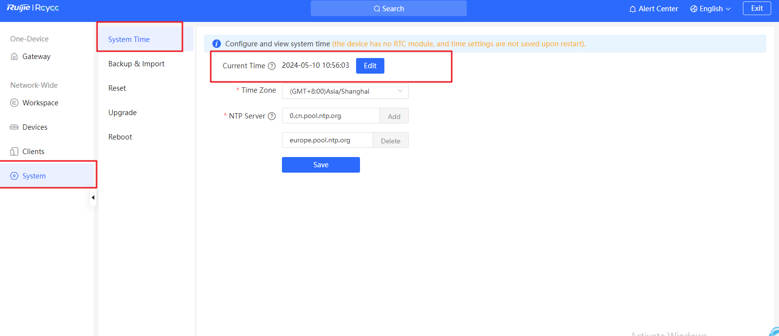

You may check what is the device current time actually is on here:
And whether it is consistent with the cloud time zone you set here:

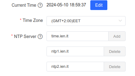

Hi Jenny
my time zone is GMT+1 , + Summer time active = GMT +2
