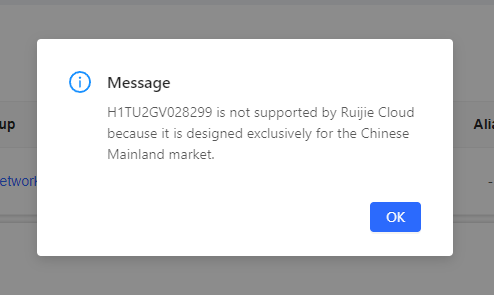

Please help me to connect my EG105G V2 to Ruijie Cloud, yesterday I already connected but today I notice that the router is not connected on the cloud.
Here some screenshot for your reference.

Hi sir,
Where did you purchase the device? Can you provide your purchase voucher?  This is my email:  liuxiyang@ruijie.com.cn. According to your screenshot, the device was purchased from China.
