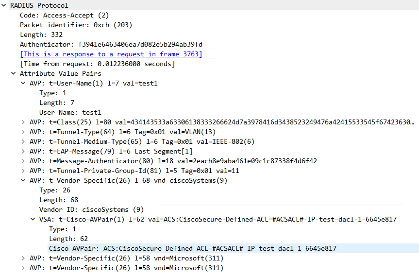

Does any body know is there a possibility to apply ACL (locally configured on AC or downloadable ACL, doesn't matter) by RADIUS Authorization results, i.e. apply ACL  that is pointed in Radius ACCESS-ACCEPT packet?
I have tried both variants:

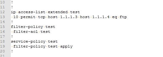

  • locally configured Extended ACL on AC, and point its name in radius:Filter-ID attribute
  • downloadable ACL configured on RADIUS server side, like on Cisco or Huawei products
  • In case of local ACL, controller does not apply it, and looks like it just ignored Filter-ID attribute:

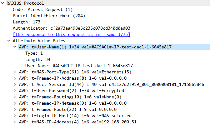

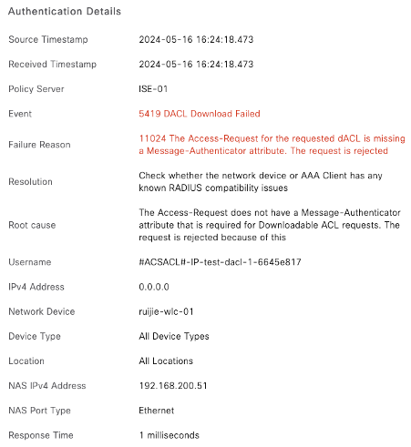

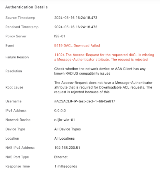

  • In case of dACL all much interesting: I have uses Cisco-style dACL, I see the corresponding vendor-specific attribute in ACCESS-ACCEPT. Moreover, controller recognizes it, and answers with new request for getting this ACL. The problem is that in a new ACCESS-REQUEST there is no mandatory Message-Authenticator attribute, and Radius-server rejects this request (sending ACCESS-REJECT with the reason "11024 The Access-Request for the requested dACL is missing a Message-Authenticator attribute. The request is rejected

OK, #1 is working perfectly!! Thank you very much, it is enough for me! We can mark this topic as "solved'!

1.For the first method, the AC locally configures the extended ACL and specifies the ACL name to be changed in the Filter-ID attribute. After packet capture, it is found that the AC does not apply this attribute
A policy needs to configur on the device. The server delivers the policy name through attribute 11
you may refer to this configuration

    • Cisco ISE (RADIUS server) successfully includes vendor-specific (26) attribute with dACL name into final ACCESS-ACCEPT packet destined to controller (authenticator). Please, find second ACCESS-ACCEPT screenshoot in my initial post
    • Controller sends a new ACCESS-REQUEST to Cisco ISE (look at the ACCESS-REQUEST screenshot in my initial post) with dACL name in the Radius-User-Name (as expected), but:
      • does not include
        Message-Authenticator attribute that is mandatory
      • does not include vendor-specific attribute "aaa:service=ip_admission"
      • does not include vendor-specific attribute "aaa:event=acl-download"
    • Cisco ISE (RADIUS server) receives ACCESS-ACCEPT from the controller, does not find Message-Authenticator attribute (that is mandatory attribute), and rejects it with sending ACCESS-REJECT to controller, with description "11024 The Access-Request for the requested dACL is missing a Message-Authenticator attribute. The request is rejected
