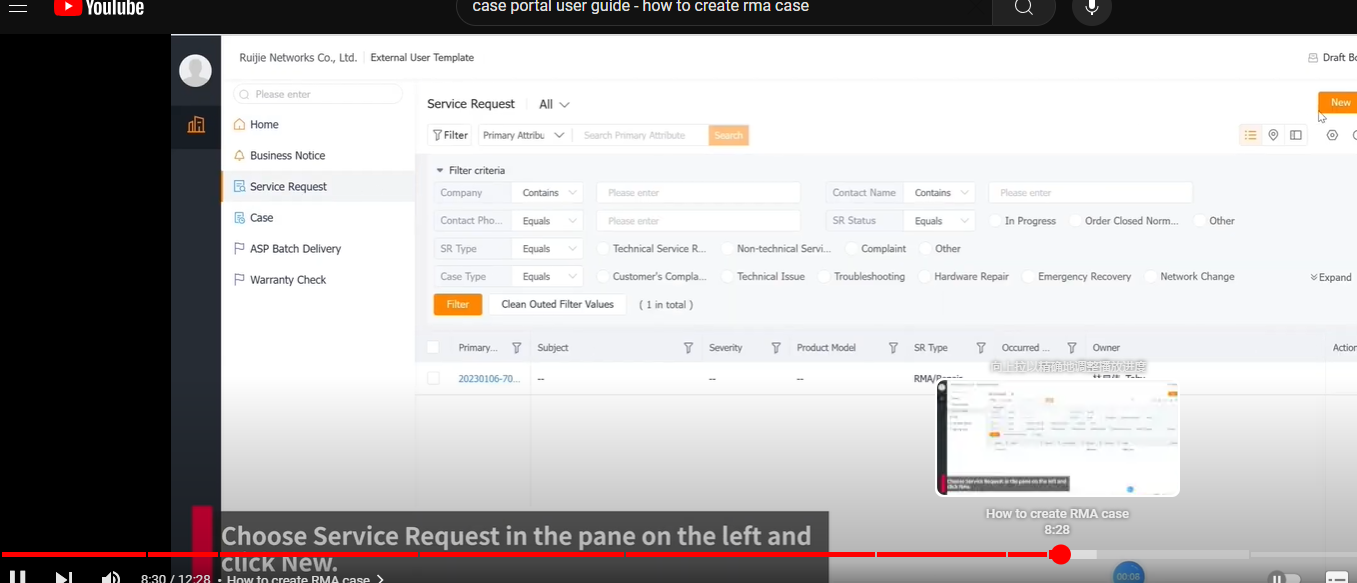

Hi sir,
Sorry for my late reply.RMA means when the the hardware issue(firmware damaged orchip of the device is damaged), and this device is under warranty, you cancontact our ASP partner for a new replacement.
or you can create a RMA case via this link:
https://www.youtube.com/watch?v=KhSnHOqvOLU&t=613s
Fill in the current device address and your current contact number and email address,our ASP will contact you and replace device for you
Ross

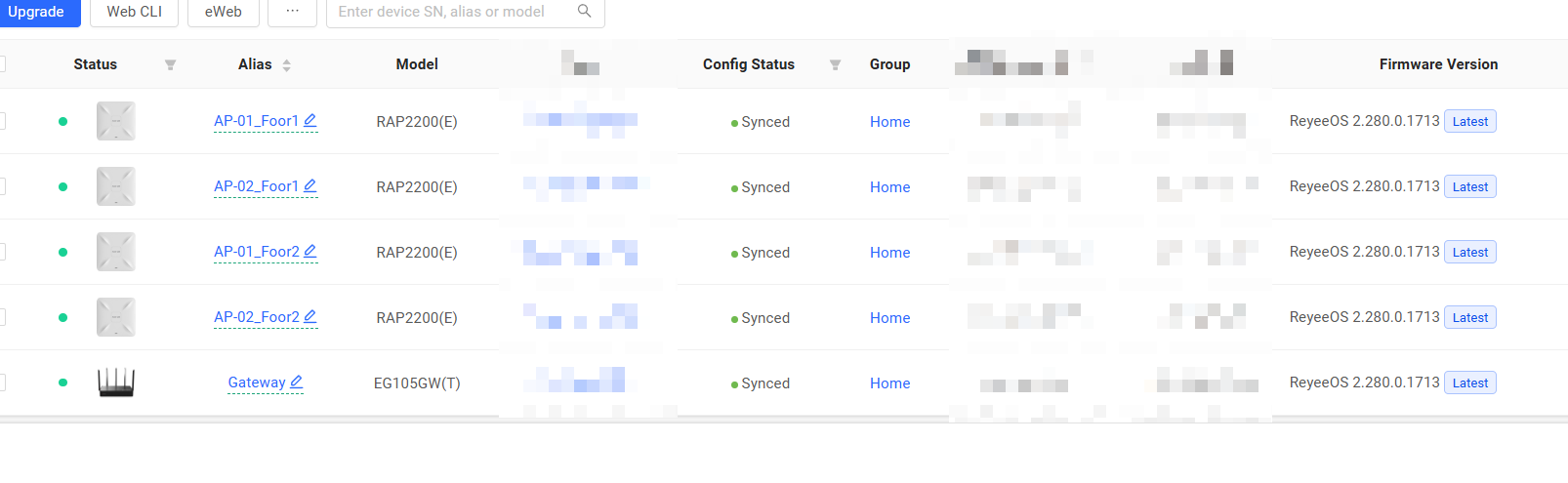

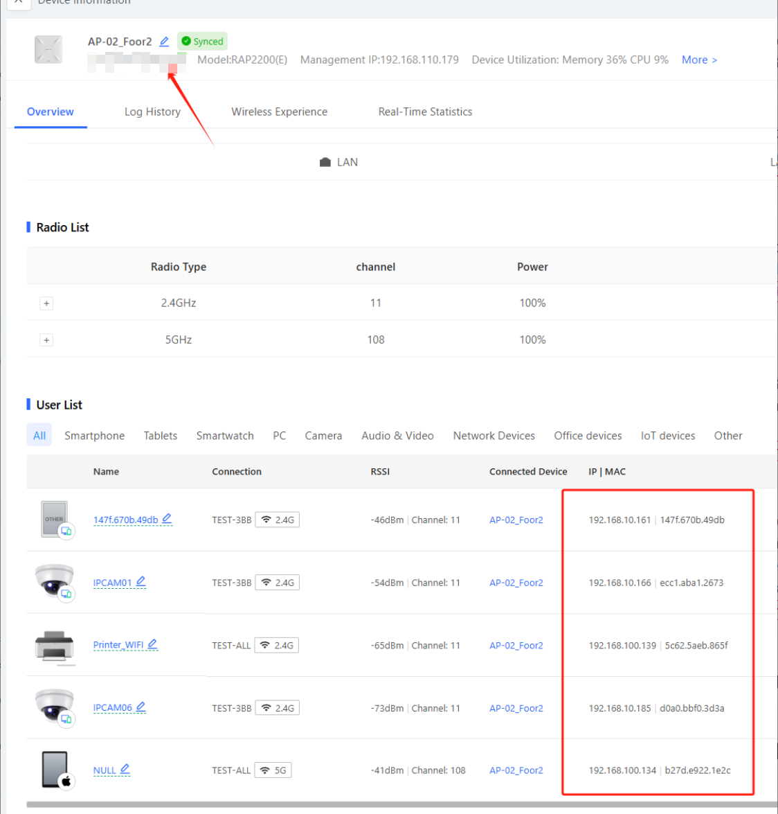

now i update last fw
need restore config 1 time and reboot
i think can runing
