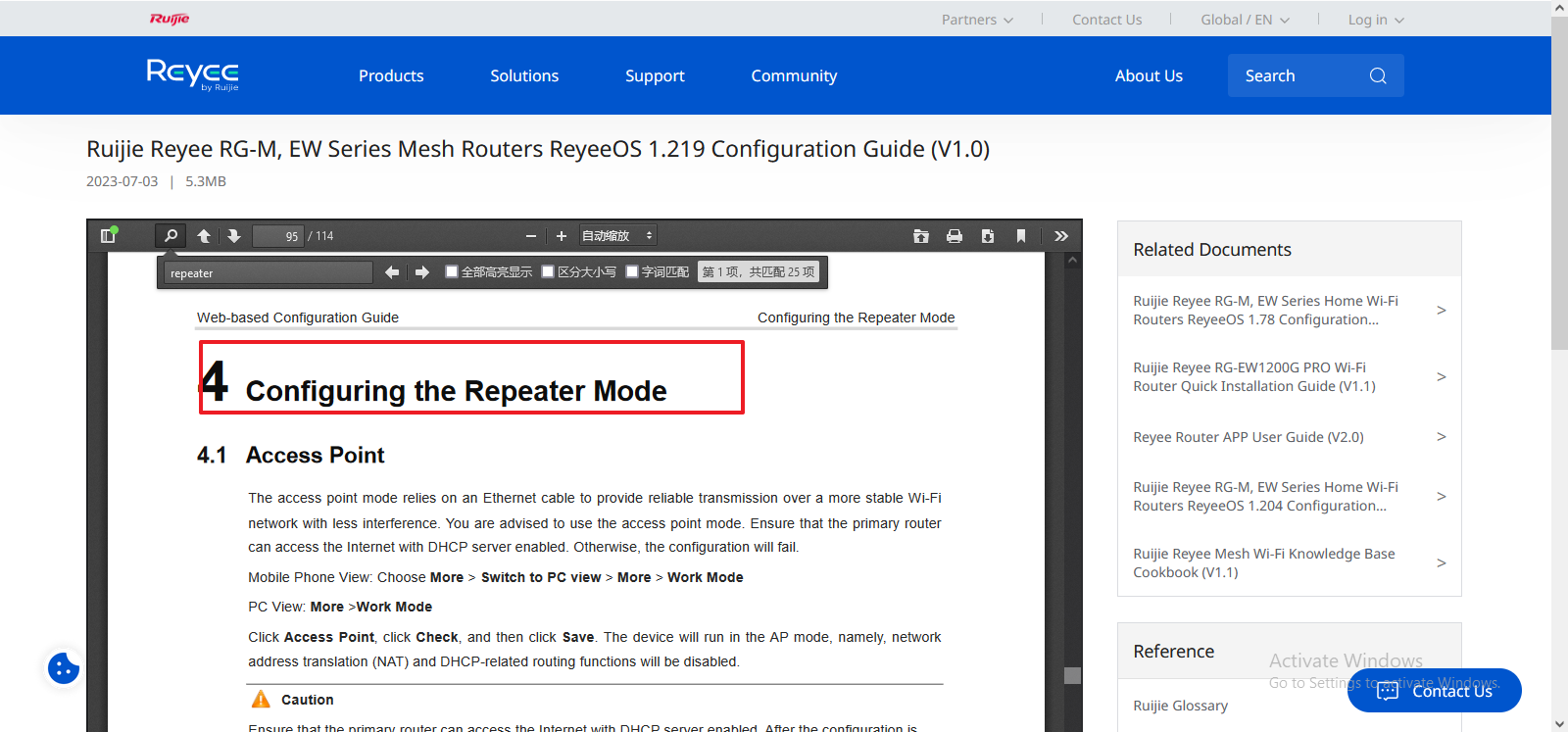

Do you want to add the EW router in your current starlink router network to extend the current wireless signal?
EW router is compatible to do this in repeater mode to establish a wired/wireless connection between the startlink router and the EW router, extending network coverage. Here is the guide you can refer to configure repeater mode on EW router on page 95: https://reyee.ruijie.com/en-global/resources/preview/ruijie-reyee-mesh-routers-web-based-configuration-guide
