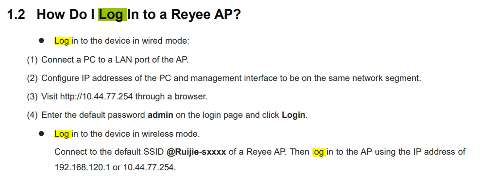

1. Is there any ssid broadcasting? Can you log in the device wiredly? If you don't know the method, please help refer to the image and have a try.
2. Please try to reset the device by pressing the reset button about 10 seconds. Then repeat the point 1 and confirm if you can log in the device.
