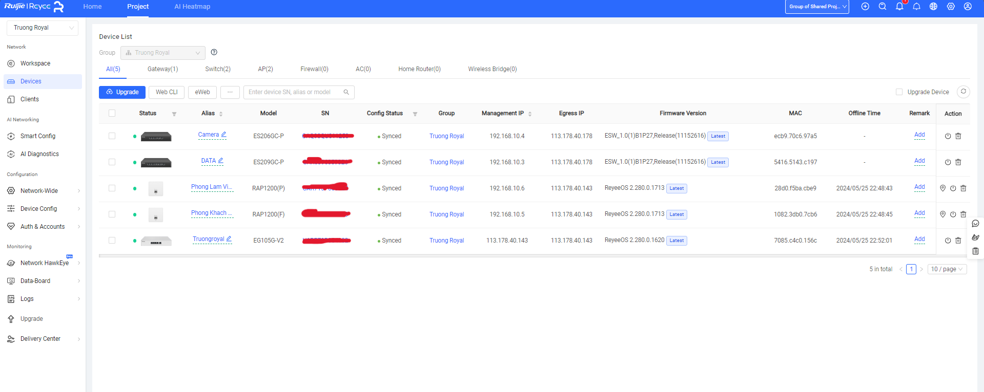

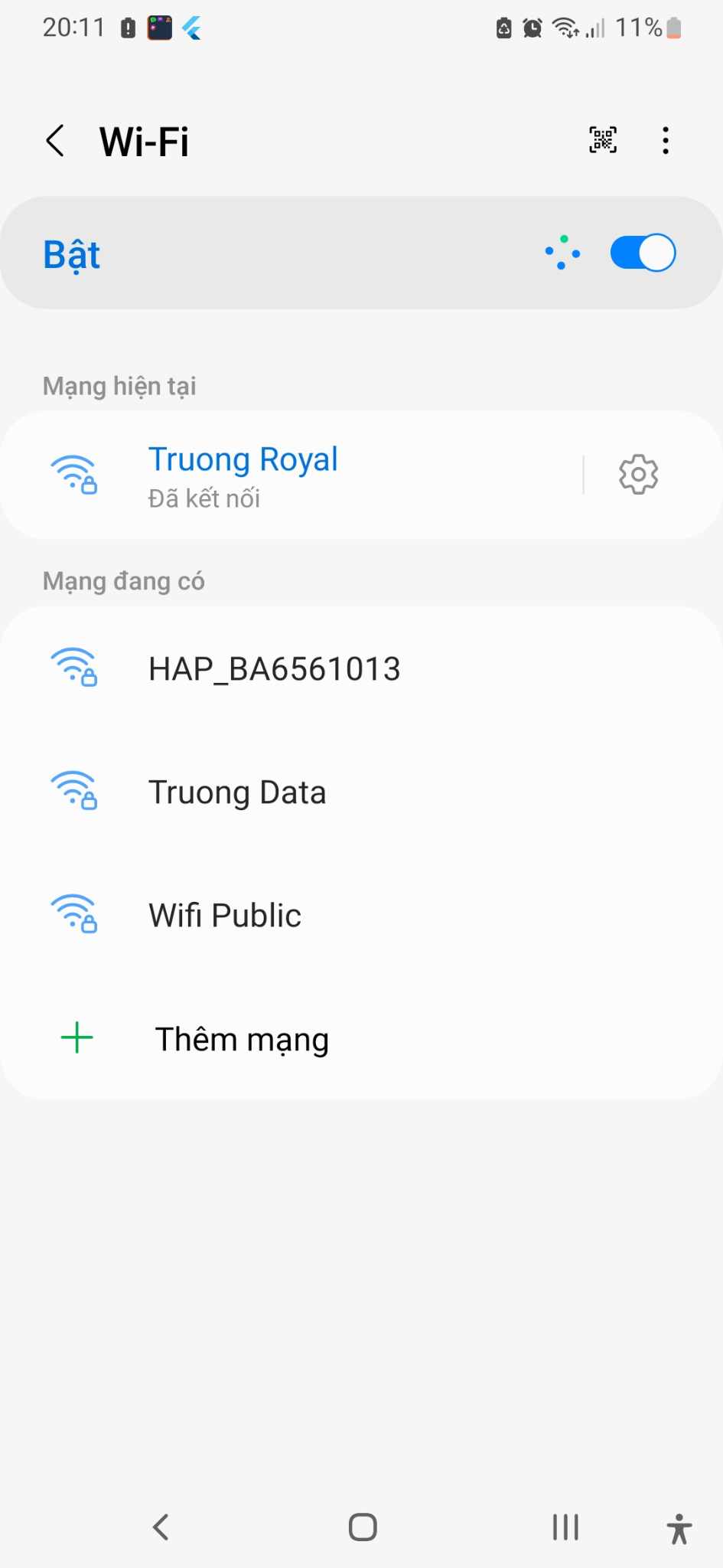

Dear technical department,

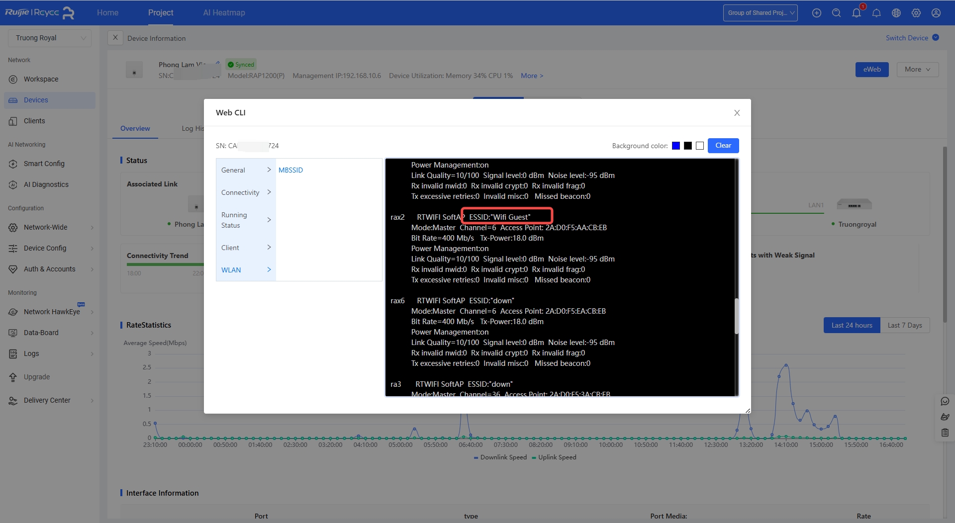

I have found issue with SSID name as "HAP..." with RG-RAP1200P and RAP1200F ( setup mesh and sync config together with gateway already ) setup 3 different name , each of it set with 3 different vlan. I have to test to downgrade ( with uncheck the retain configuration ) firmware from current ReyeeOS280 ( lastest ) - ReyeeOS262 ( this firmware which is solve bug SSID name as "down" ) - ReyeeOS260 and ReyeeOS230 but all of them also not solve that issue.

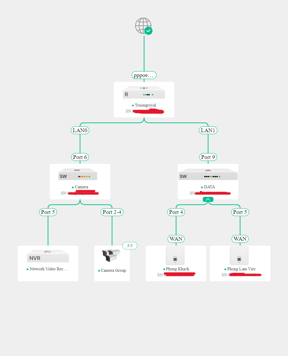

* There is my topology include devices have issue as picture below:
* There is bug I found:
Hope you release firmware fix this bug soon or solution other

After my inspection, I don't see this BSSID on the AP. Can you connect to this SSID and check if there is a user's connection information on Ruijie Cloud? Or you can try to close the AP to see if the SSID is still there.

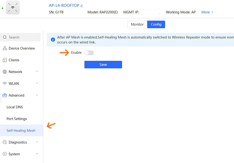

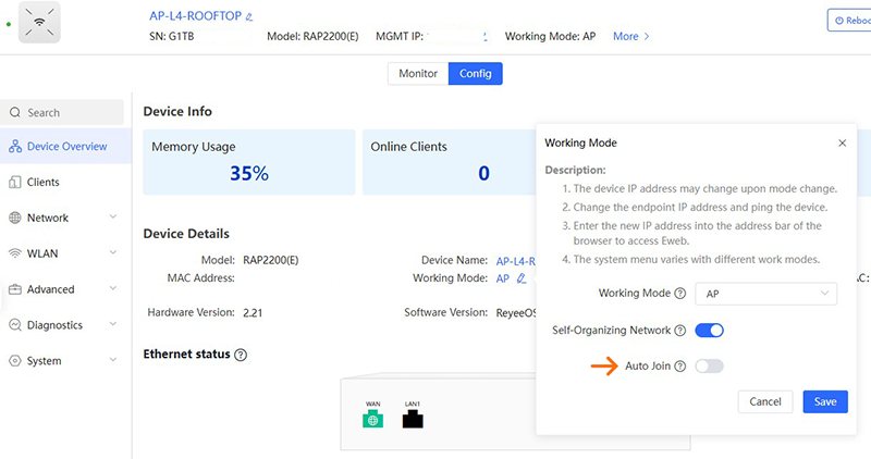

It returns to normal by disabling the Self-Healing Mesh and Auto Join features, then the @Reyee- SSID will no longer appear.
