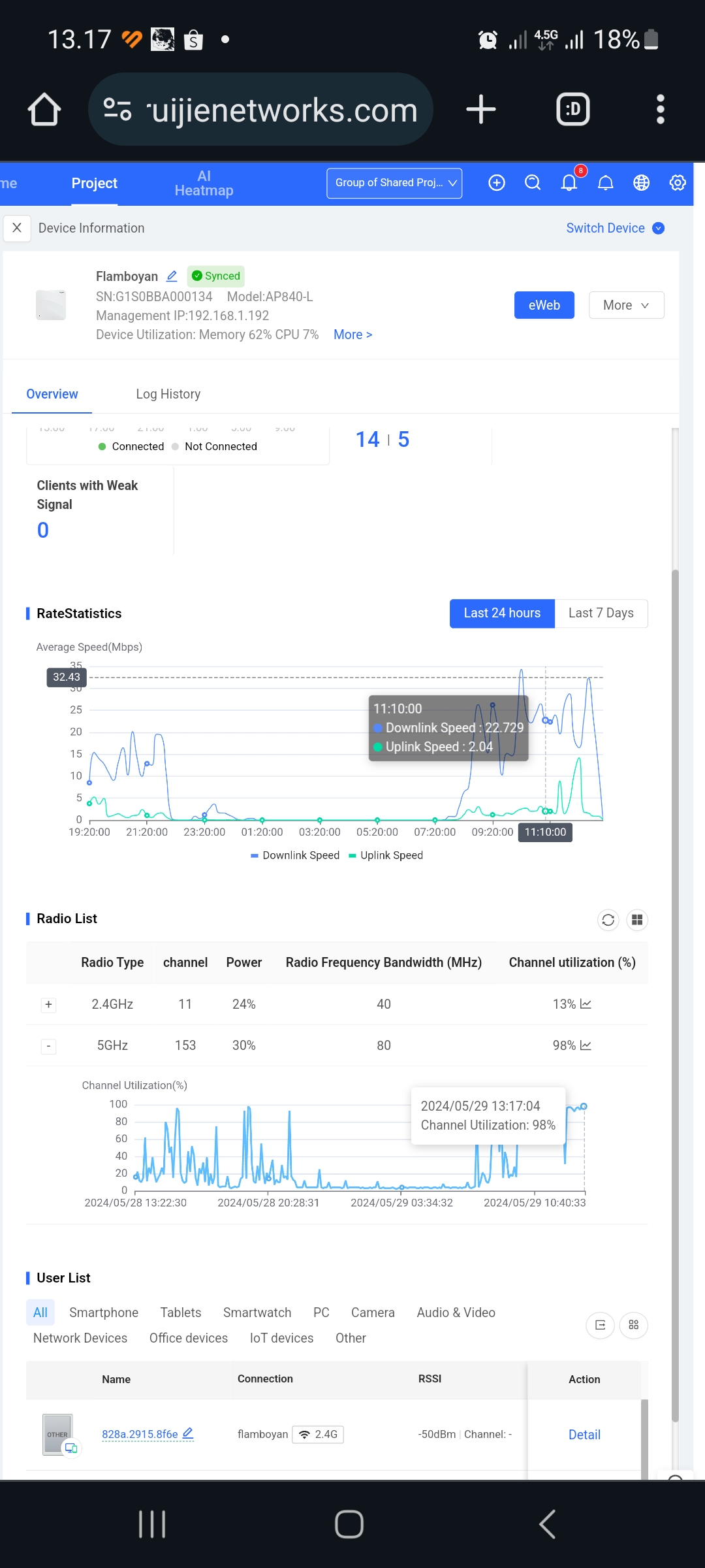

Channel ultilization 98% Reply
IT FAVE
3197 1 2024-5-29 14:31:56
Im using AP840
Channel ulization 98persen connection lagging
RG-AP840-I
0 2024-5-29 16:29:23 View all replies
You can change another channel of the AP on this page to see whether it is the same issue:
The adjacent AP channels must be non-overlapped channel to avoid same frequency interference and packet loss. For example in non-high-density deployment scenarios, 2.4G channels are recommended to use 3 non-overlapping channels 1, 6, and 11 for planning. If it is a high-density deployment site, it is recommended to use 4 channels 1, 5, 9, and 13 for planning; 5G channels are recommended to use 149, 153, 157, 161, 165, 36, 40, 44, 48, 52, 56, 60, 64, a total of 13 non-overlapping channels are planned.
