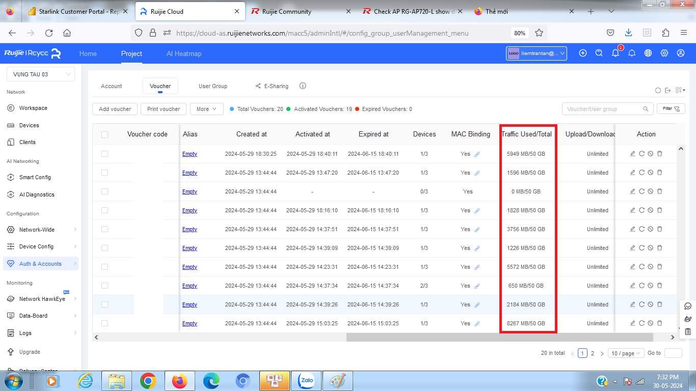

Dear Sir,
Could you help me check the AP Type RG-AP720-L can show data used/total at the bellow picture? If can, how do I configurate network?

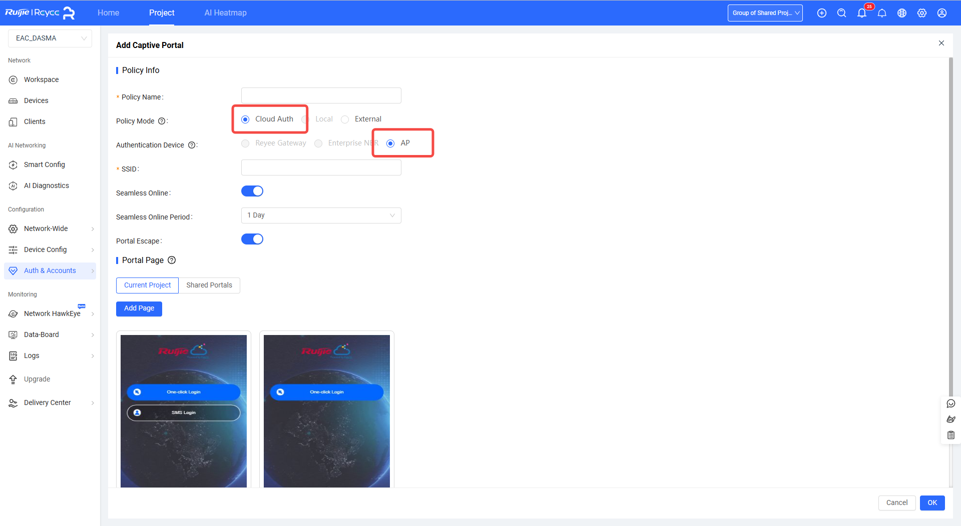

This data is based on the quota function on Ruijie Cloud
Ruijie series AP can support this , but you need to check whether the portal configuration configured is the  Ruijie AP portal

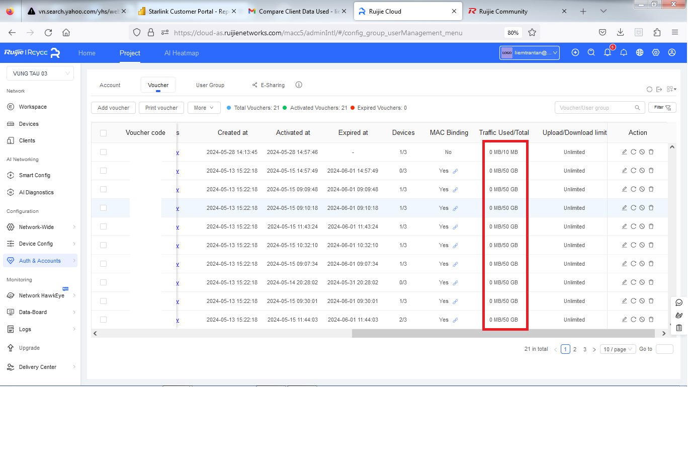

Dear Joy,
My friend help me configure NetWork, the Data show already, but I don't know how they made it ...
Can you check for more information ...

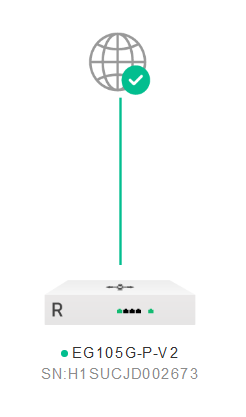

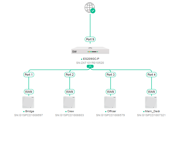

They creat 2 project, one for router and one for AP, Switch
You can see bellow picture ..
And here data show:
How do they do?
Thanks for your support!

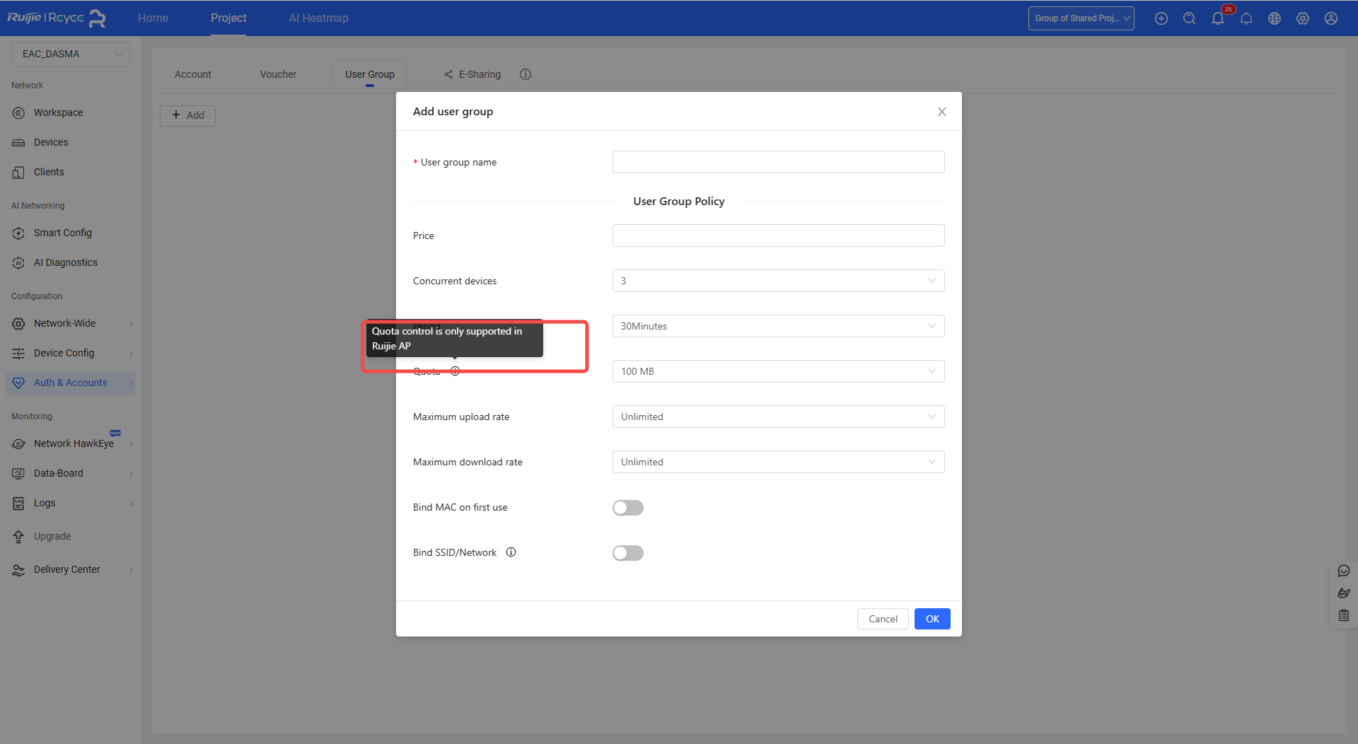

After you enable data quota on this page, the authenticated user used data can be recorded and uploaded to Ruijie Cloud by the Ruijie AP.
