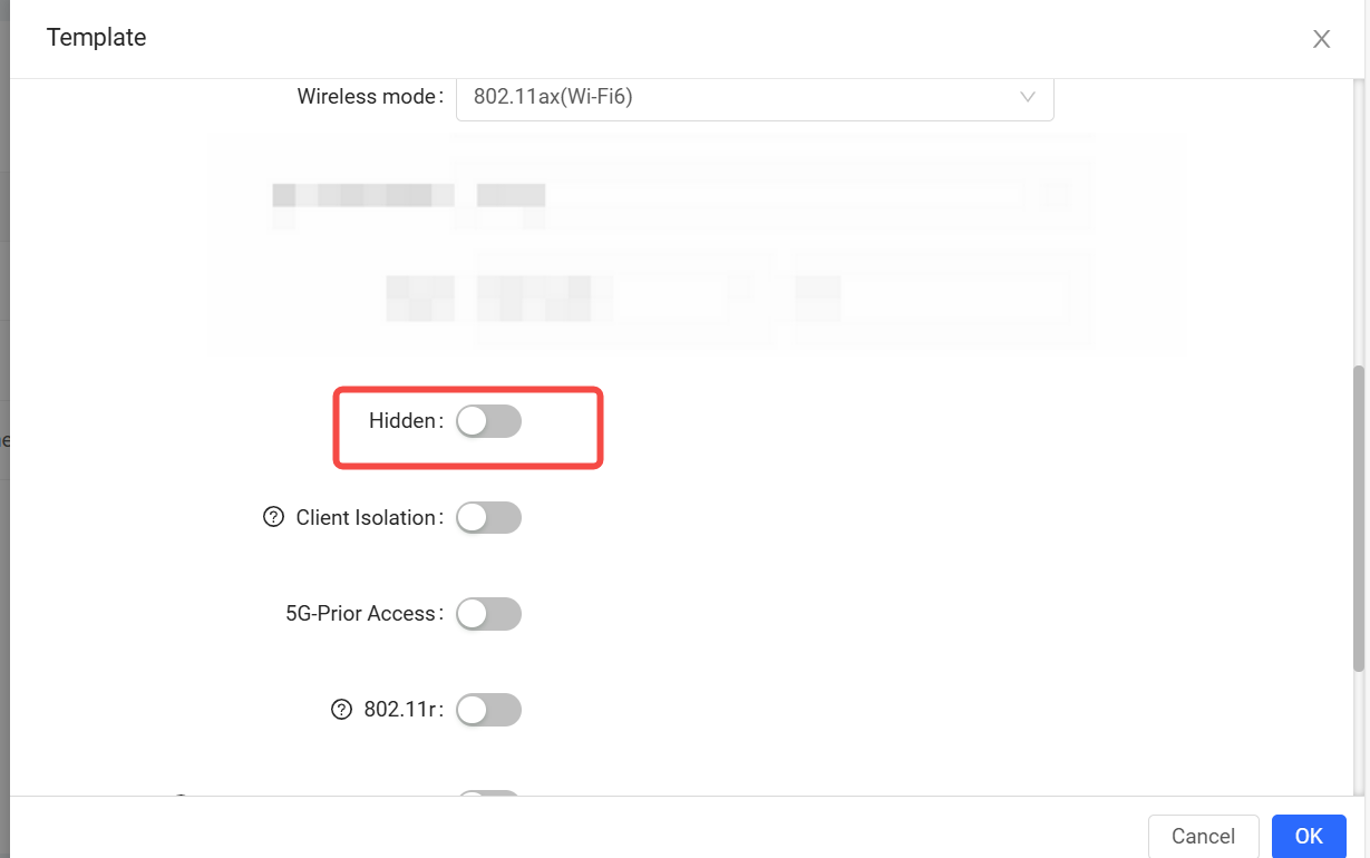

If you are referring to preventing clients in other rooms from detecting the SSID from your access point, you have a couple of options:
1. Hide SSID: You can configure the access point to hide the SSID. This will prevent users in other rooms from seeing the SSID, but it will require users in the room to manually search for and connect to the hidden SSID.
2. Adjust SSID Radio Strength: You can also adjust the radio strength of the SSID broadcast so that it only covers the desired area, thereby preventing users in other rooms from detecting the SSID.
Please let us know if you need a detailed guide on how to configure these settings.

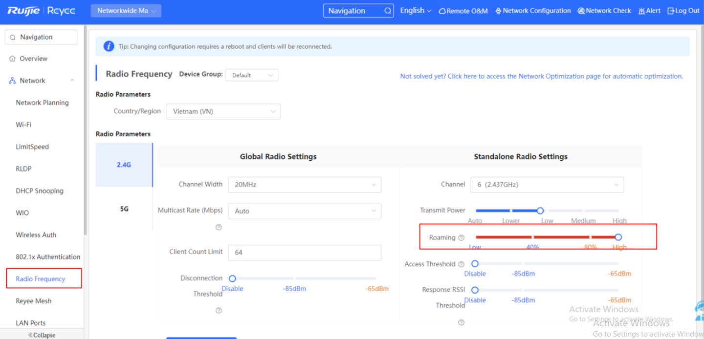

In this situation, you may set the APs to different SSIDs so that the client can only connect to the specific SSID that the APs have to get higher wireless signal strength. Here is the guide to configure different SSID for different APs in the Same SON network: https://community.ruijienetworks.com/forum.php?mod=viewthread&tid=1877&extra=page%3D1
Because it is client behaviour to choose which AP to connect. Some clients would prefer stability, so keep connected to the old AP which may not be the best one.
If you want all the APs have the same SSID and still the clients need to connect to the nearer AP, you can try to increase the roaming sensitivity on this page:
1. Roaming sensitivity is the rate at which your device selects and switch to the nearest available access point, offering a better signal.
2. A higher roaming sensitivity level indicates a poorer Wi-Fi coverage.
If there are any problems, please feel free to contact us and provide more details about your AP deployed diagram and the issue you are encountering. We will try to provide you better solution for your requirement.
